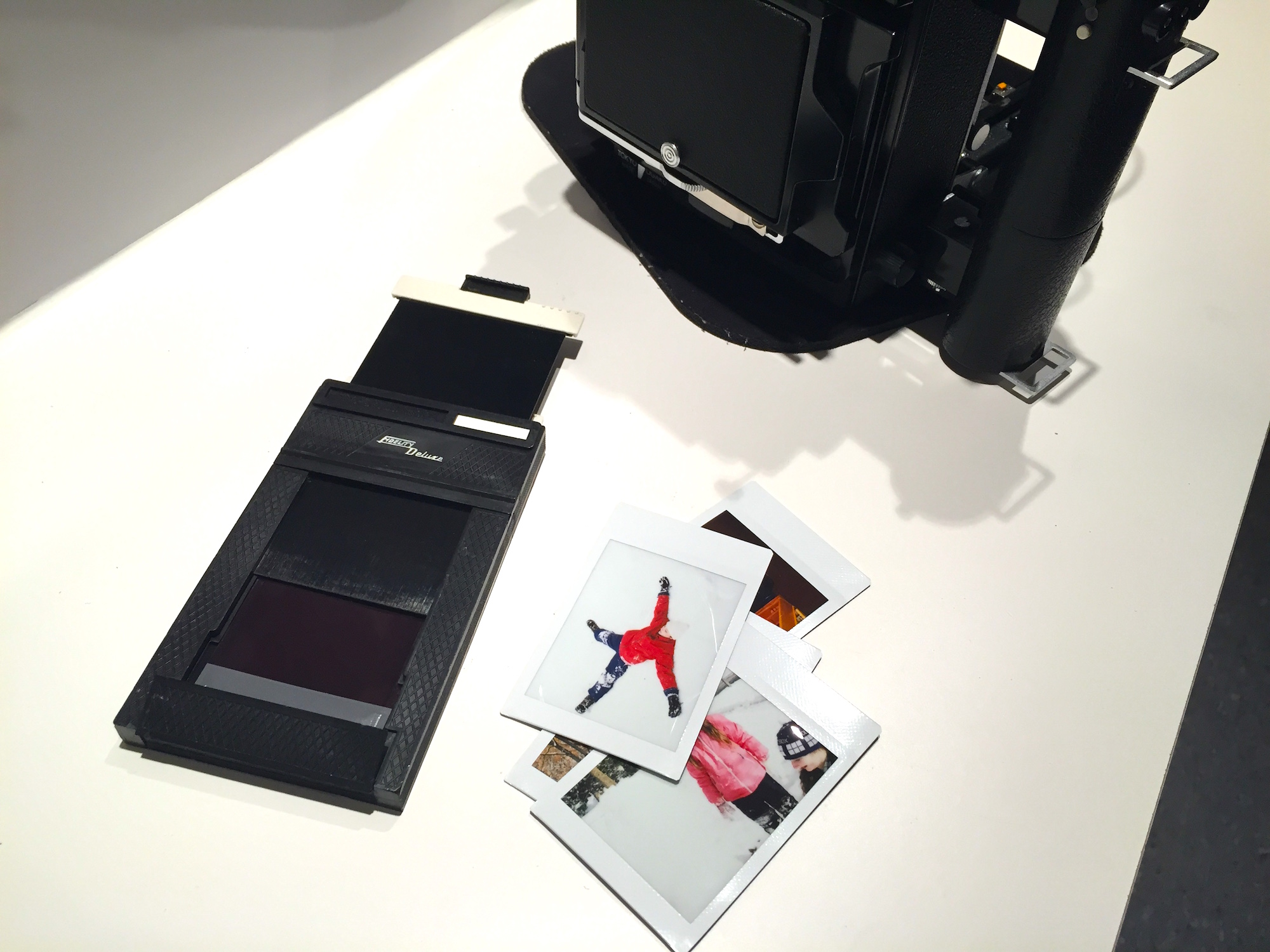

I use instax film in my Horseman medium format camera by putting the film in the 2x3" (6x9cm) film holders. Then I process the film by putting them in an inexpensive Instax camera. I have been doing that for a few years now. I wonder if the instax film will fit in these film holders? As you can imagine, when the instax film is put in film holders, there is no issue with focusing.

This is very interesting. This way, the film is mounted in the exact correct position to focus through your normal viewfinder. I have seen a similar technique where someone uses the cut film holders on the TLR Rolleiflex. There, the entire normal back must be changed with a back that specifically holds the cut film septums. The Hasselblad unit would be more flexible. I am still surprised that Fuji has not made a Instax back for Hasselblad and for Mamiya RB/RZ. I think there would be sufficient customers.

I taped an Instax film to a piece of paper and pulled the whole thing through the rollers of a Polaroid back. It did spread out the developer. Not all the way , though, but maybe if I pulled slower.
The idea was that I would collect a number of Polaroid backs and just put a single instax film in each one. Not unreasonable assuming the extinction of pack film drives the Polaroid pack film backs to near worthless.
