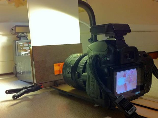

There is a school of thought that says any dense colour negative can be printed, just shine more light through it.
With a scanner this is not always possible, hence pentaxuser suggestion of an optical print.
Over developing is different that over exposure but we live in hope.
If an optical print is not feasible, then you could try taking a photo of the neg with a digital SLR and flash.
See this: https://petapixel.com/2012/05/18/how-to-scan-film-negatives-with-a-dslr/
Just a suggestion.
Let us know how you get on, please.
