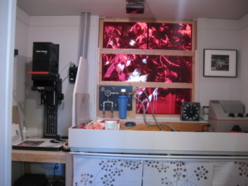

+1 to a window. If you plan it well you can print while looking outside, I do. My darkroom window looks out to the garden and it's specially lovely in the afternoons when the light is raking and the wind from the SF bay blows in. It's a pleasure printing like that. I ordered red film form a company (I can't quite remember the name right now) and it works great. I do use a meter to get my work print. Shades have to be drawn while I measure, but once the first work-print is done, the shades come down, and the rest of the session is done while looking outside.
