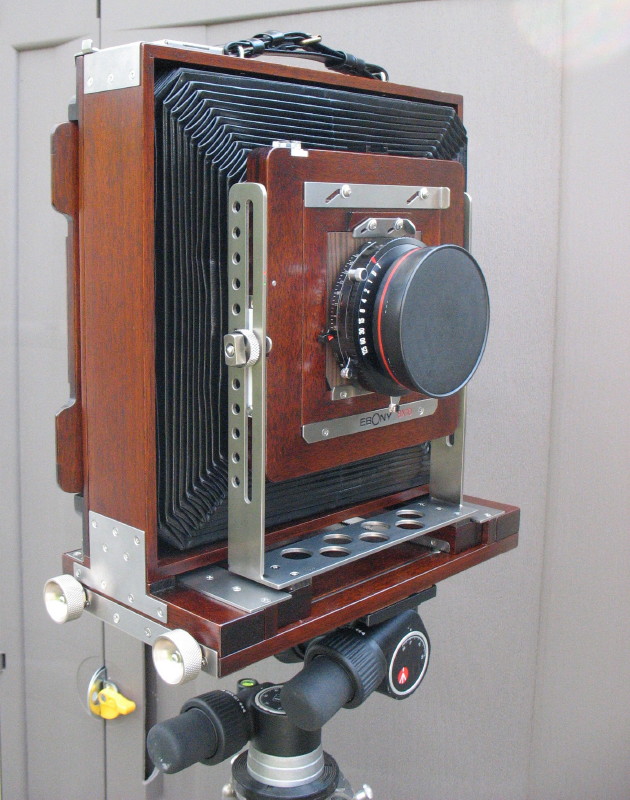

I use an Ebony SLW810 which has minimal front movements, rise, fall and tilt. It's great to transport with lens attached, quick to set up and extremely rigid.
