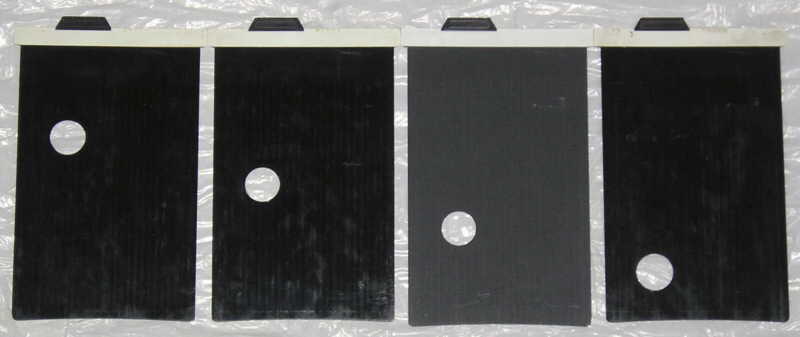

I sacrificed the dark slides from a couple of really ratty film holders I had to make a set of masks, allowing me to make eight separate exposures on one sheet of film. Each has a Âľ" hole drilled in it, offset to one side of the holder. Using each in turn, and swapping them around in the holder allows the eight individual exposures.
I use one sheet for determining EI, including a zone VIII exposure, to see how close my standard development time using the selected developer is to the required time (if it is way out I will use another sheet for EI/zone VIII). Then a couple of sheets for -2/+2 development times, and interpolate for my -1/+1 times.
If I am evaluating the negs by eye, I shoot a textured surface, if I am using a densitometer, I shoot a plain surface.

If you want to determine the full range from -2 to +2 (presuming the film you are testing is capable of that much expansion, and you may discover that it isn't, which is useful to know), I could see using around 25 sheets. That's one speed test and five development tests, and maybe more if you decide to try a different developer for -2 or -3 or maybe run another speed test for +2 or if you can't get +2 run a test for selenium intensification, etc. That said, I don't test every film under all conditions.
snallan's method with the darkslide masks is a good one for saving some film. I've also seen a single darkslide mask with 8 holes covered with tape, which is another approach, if you don't have so many spare darkslides.
Another method is to cut up a sheet of film for development tests. Just make sure you've got relevant detail or a Zone VIII patch to read on a densitometer in all the strips.
