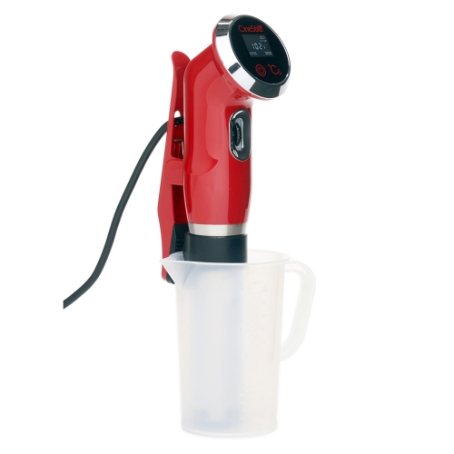

See Cinestill Temperature Control system.
For the price is the better choice.
For sure you can buy a cheap sous vide in eBay... But that one o offers much better quality and was developed taking in mind the use in photography.
It's supposed to be more precise in temperature range used in photography (which are significantly lower that the ones used in sous vide cooking), something different in the resistance too, and the software is designed to use in photography development workflow, instead meat cooking!! =D

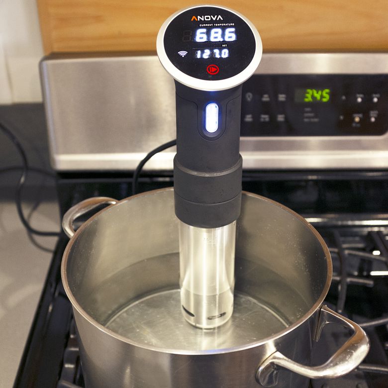

The only thing that sets the cine still apart is those two handle things that supposed to grab bottles or tanks. Save your money and get they cheaper ones on ebay. I have an Anova that I use for cooking and it has held up pretty well for almost 2 years of almost daily use.
I use the Anova and never looked back. I checked the digital temperature readout with a lab thermocouple and it was within 0.1 degrees C.
I bought the plastic food container made for the purpose to hold the water bath. A cheap way to keep the system at temperature.
I have a 1000w one, payed maybe $50 for it. I use it to process c41. Throw my bottles in a plastic container, fill with water, turn the guy on and measure the devs temp. Reaches the desired temp pretty quickly.

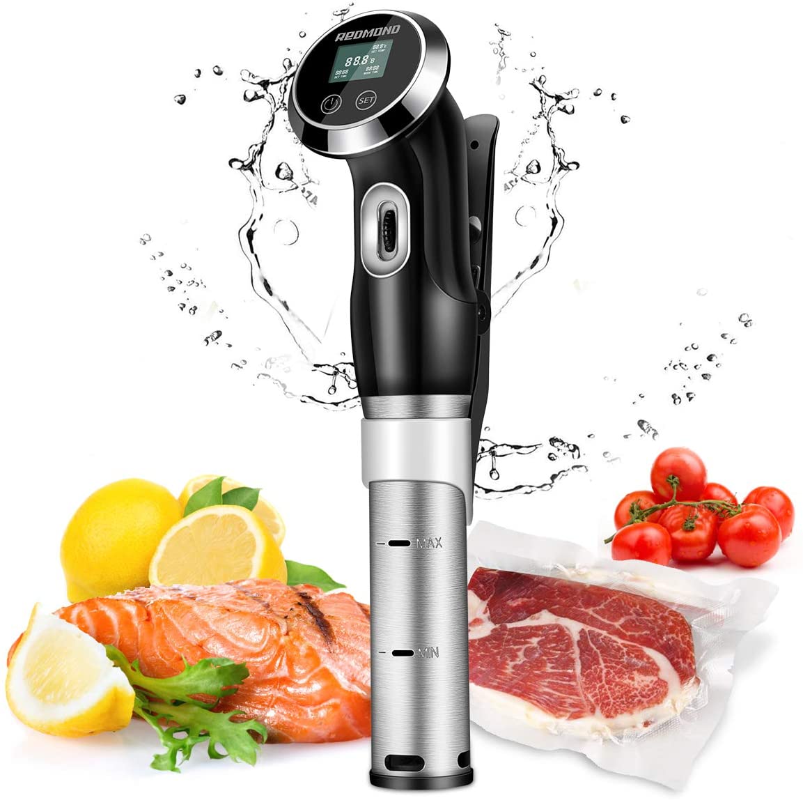

Physically the same device as normal sous-vide cooker from Amazon for half price. Same temperature range and control.
I would really like to know where the development for photographic use is.
Really?
View attachment 246652 View attachment 246653
I have exactly this second one but mine doesnt say redmond. I think they rebrand that same device for a lot of brands, including cinestill.. It works totally fine in any case. Still gotta use a thermometer to check the temp of the dev while its doing its thing.
The cinestill Sous De Vide machine is just rebranded to cinestill. I've seen exatcly the same kind of sous vide machine but on different color and logo.
