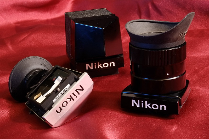

I found the Nikon sports/action finder (see the finder in center of the image below) very useful when I was shooting macro to avoid unwanted camera movement when looking through the viewfinder; sports where keeping my eye away from the viewfinder allowed me to keep better track of action on the field; and at gun ranges where I had to wear protective eyewear such as goggles.
