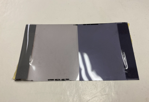

I developed some film this week and I noticed that the base tint of Kentmere 400 seems very dark.
I bought the Kentmere and some Delta 400 at the same shop, they commented how they were having trouble keeping film in stock; they get a brick in from Ilford and it's sold in 3 days, so the film was fresh and in date. I developed the film in a Jobo with Ilford ID-11 used one shot. Fixer was Ilford multigrade, mixed fresh for this film.
After the film was dried and I was sleeving the negs tonight, I noticed how much darker the Kentmere leader was compared to the Delta. Is this normal for Kentmere? I have not used much of it before. The only reason I bought it this time was the shop had 2 rolls of Delta left, and the Kentmere was the other 400 speed film they had.
Delta 400 on the left, Kentmere 400 on the right.
That doesn't look right to me. I've only shot this in 35mm and I don't recall the base was significantly darker than other comparable films.

Yea, that's too dense for normal bd+f. I've measured the base density of Kent400 in 35mm as 0.34 consistently which is same as my HP5 measurements but a bit more than TriX or XX at 0.26...all in D23. In old TriX (2 years out) I get an additional 0.15 bd+f.

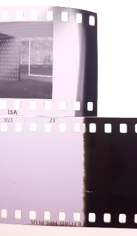

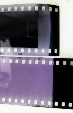

Here's the sample I referred to earlier:
Rollei RPX 400 on top, HP5+ bottom.
Same pair, backlit:
As said, density measures pretty much the same as what @Saganich reports above.
I've not shot Kentmere in 120, so IDK what base they use on that, and again, the Rollei RPX I used was purchased in 2019 or so (could have been 2018).
Edit: I also came across a HP5+ sample that I processed in Instant Mytol and might have washed longer; this measures 0.27logD base density.

The purple hue looks like anti-halation layer that isn't being softened in development, and/or fixed long enough and/or washed away. When I have this issue I add a minute or two to the fix and about 10 min extra to the wash. For the Kent400 35 I'm fixing 5 minutes in TF5 rapid fix and washing at least 30min and haven't had this issue. Often I'll know when the fix is petering out because the purple starts to increase.
