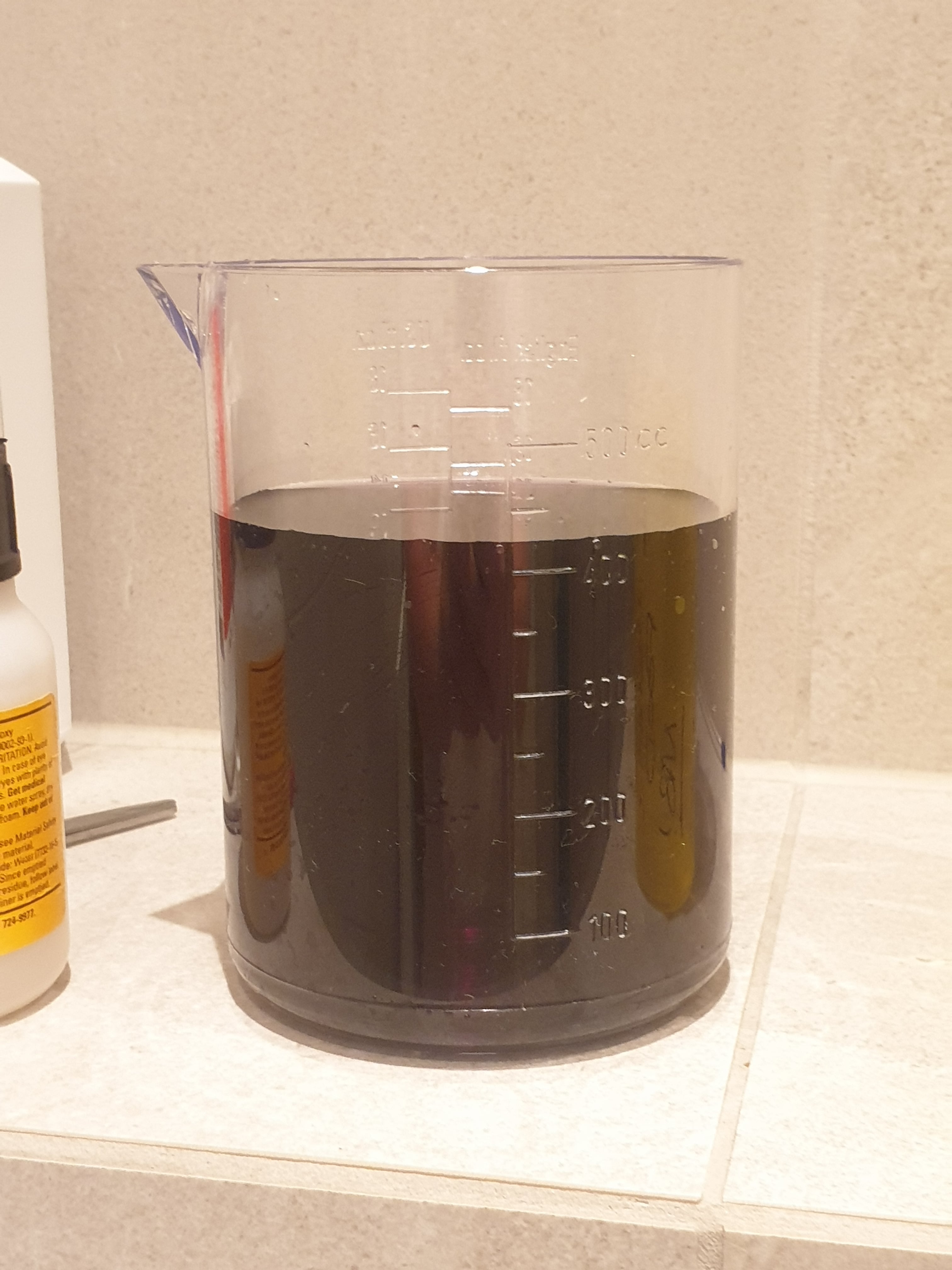

Hello everyone, I just wanted to double check if there's any issues with using R09 One Shot (Rodinal) in a stainless steel tank.
I'm asking because I just developed a medium format roll in my Kindermann 1x 120 tank, and when I poured out the developer, it was a very dark purple, and looks almost black when it's in the beaker.
I have used Ilfotec DD-X in this tank before with no problems, and with that, the developer is a very light brownish-red color, and almost completely seethrough.
It's worth noting that this roll was very underexposed as I metered totally wrong, so it could just be darker because the images were so underexposed, but I wanted to ask before going any further just in case Rodinal isn't actually safe to use in my tank.
I attached a photo of the used developer, both the stop bath and fixer look normal.
Thanks in advance,
Mick

Its quite safe, especially when you consider everything should be rinsed and put up to dry after every session. Some color bleaches can be rough on stainless but is really no problem for the amount of time its in contact before being washed out.

The color you're seeing came from the film. Several 120 films have a washable dye as antihalation (Fomapan, for instance, has a bright blue/green dye in 120 only).
Underexposed would produce less oxidation of the developer (if that were the source of the color) because less halide is developed to image silver.
Generally, stainless is impervious to sodium or potassium hydroxide -- enough so that even Rodinal(-alike) concentrate won't do any more than spot-clean the material. Drain cleaner has a much higher concentration in use, and is safe for black iron and plastic drain pipes, as well as brass tail tubes and P traps, as long as exposure time instructions are followed.
Thank you for the explaination, I was just surprised as this was just a roll of Kodak Tri-X @ 400ISO, in Rodinal 1+25 for 7 minutes, and on my other rolls of this film with other developers (Ilfotec DD-X and Cinestill Df96) that color wasn't there in my developer. The more you know! :smile:

The other thing is that the oxidation color of Rodinal-like developers is generally pink (barely any) to very dark brown ("like Coca-Cola" or "like coffee" are common descriptions for old Rodinal in the concentrate bottle). Even at 1:25, however, there isn't enough concentration of developing agent to produce a dark color; the furthest I'd expect it to go is a moderate straw color.
That's the weird thing to me, the bottle is less than a week old and looks great, in plastic tanks like the ones I have from Paterson come out much clearer.
Either way, if it's safe I won't complain too much :smile:

Different films have different color anti-halation dyes. I use Rodinal all the time (not in SS) and HP5+ has a brownish color, while Try X is a deep purple, almost black. Nothing to do with your tank material or Rodinal. If you presoak the film before developing, you will see the water turn same color, maybe just lighter.

I did a roll of Tri-X in Rollei R09 yesterday. The developer had turned a deep purple color and I was convinced there would be residual coloring effecting both the stop bath and fixer. The color was only the developer, not a hint of color in any other chemistry, plus my stainless steel tank is still bright and shiny.
