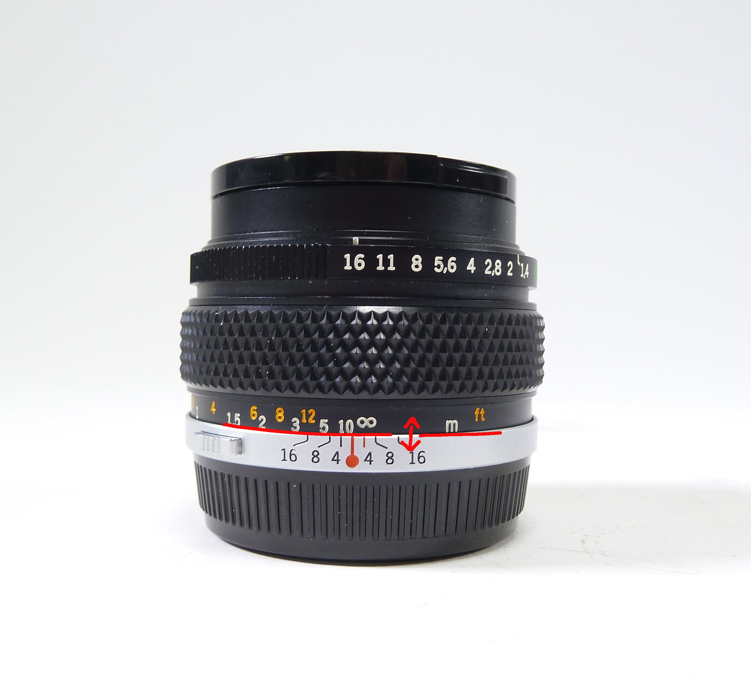

Hello everyone,
Today, on my OM Zuiko MC 50mm f1.4 lens I noticed an abnormal "play" (i don't know if it's the right word in English) from back to front at the base of the silver ring,
the whole lens moves slightly forward and backwards on about half a millimeter, you can even hear a slight "click" when you do it, it won't move much more than about half a millimeter but I'm worried it might be enough to mess up the focus, maybe even create a light leak inside the lens?
I've included a picture with this post describing where the problem is located,
I wonder if by pushing it "closed" well every time i use it i can still use it normally ? maybe the damage is too much and even when i push it it's still not in its exact original position ?
Am I better off selling it for parts or going to a repair shop, even tho i don't have much hope they'll be able to do anything ?
I would really like to keep using it because it wasn't easy finding an MC version of this lens and i don't think i'll be able to find another one in good condition soon.
If you have any idea and advice or if you had similar experiences with such lenses it would really help,
Thanks !

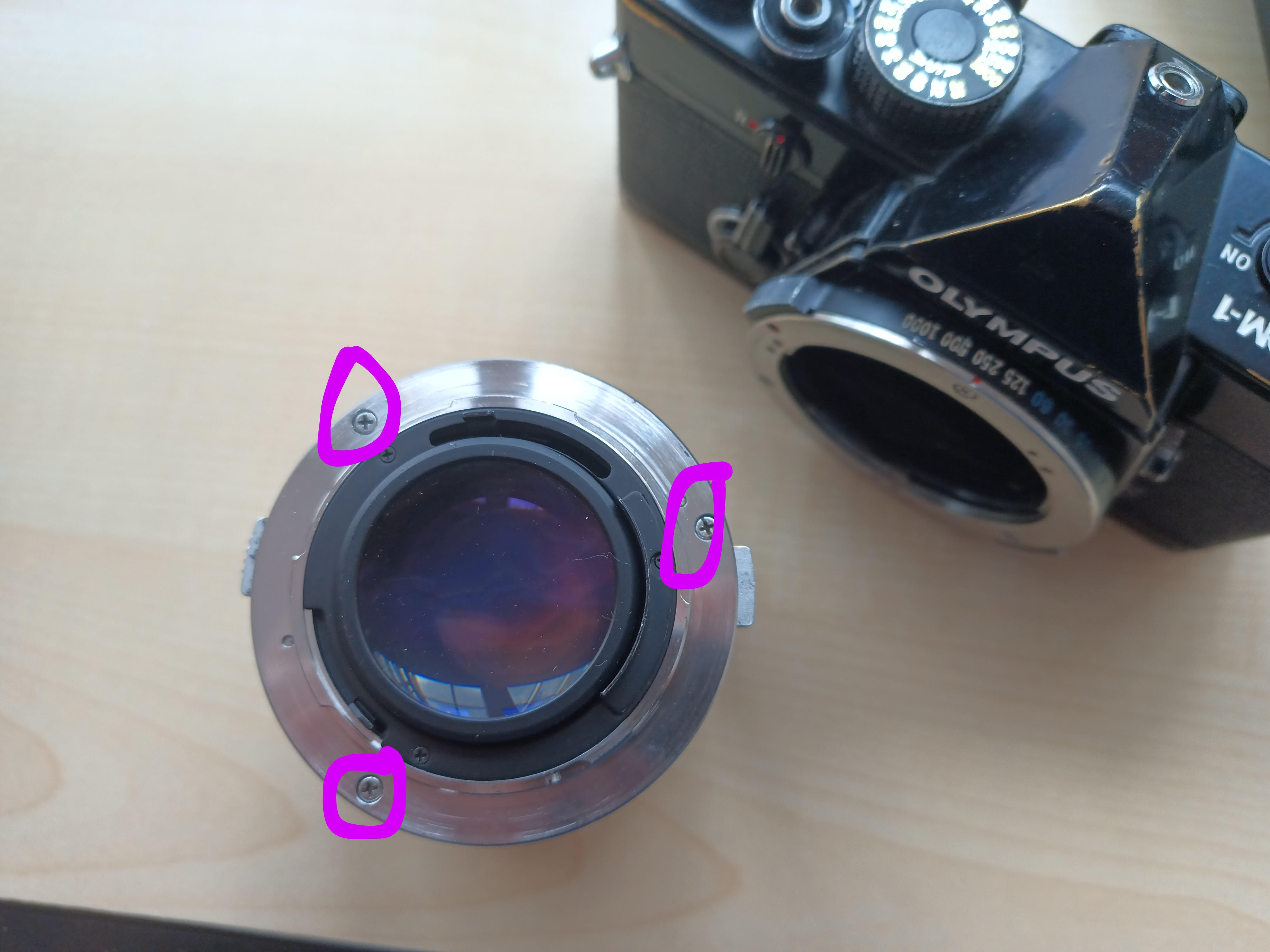

You could take a look at the lens mount. The mount often is screwed to the lens barrel and if these crews are loose you could have the effect you describe.
Is the entire lens moving forward and back relative to the lens mount? To check it, mount the lens on the camera and try to move the front of the lens forward and back without rotating the focusing ring.
If it moves without rotating the focus ring, then you have a problem that must be corrected. If on the other hand, only the aperture preset ring moves independently of the lens, then focus is unaffected, and you need only address the looseness of the aperture ring. To get at the aperture ring, the screws holding the lens mount to the barrel must be removed.
Use only a JIS (Japan Industrial Standards) screwdriver of the appropriate size as other cruciform-socket tools have a different geometry and won’t fit the socket properly and would likely damage the screw sockets.
If the lens mount is loose, then tightening the screws should eliminate the problem.
Yes, when i attach the lens to the body of the camera the entire lens moves relatively to the silver ring, i'll try to tighten the screws Daniel suggested tonight if i still have the right screwdriver and get back to you
It sounds like the mount flange screws could be loose, they are on the back of the lens:

I confirm @Ian C 's warning to use only JIS screwdrivers on those screws.
If they are loose, that is a hint that someone may have serviced the lens previously - which is not necessarily a problem, but might be significant.
I could be wrong, but I believe that when the lens came from the factory, those screws were also treated with thread locking compound to prevent them loosening under normal circumstances.
So they may or may not be easy to adjust.

Update: I got the appropriate JIS screwdrivers and tried tightening the screws on the silver mount plate but they are already really tight, if i apply any more force the screwdriver just slips and damages the screw, the play is still there and i don't know where to look next, if anyone has any idea it would be welcome
Hm... you could try to unscrew these three silver screws, take off the lens mount and look if you can find something underneath being loose... but i am running out of ideas. When removing the mount you may set the aperture ring free, these sometimes have a click-stop being created by a single ball which may come out if you remove the mount... so be careful.
I worked on this lens to clean some haze. The issue you describe seems odd to me. You should try to remove the bayonet ring to get a closer look since you have the tools. The aperture linkage is there but the aperture control in on the top.
