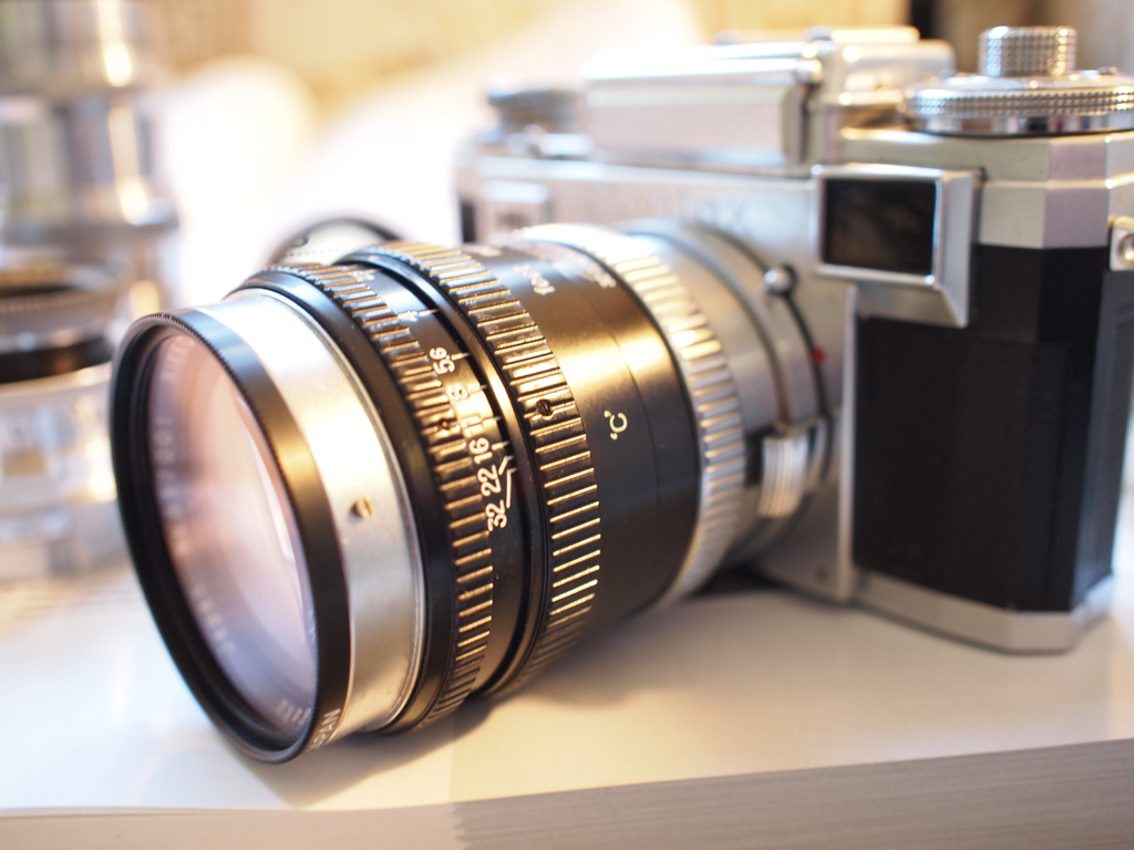

There are a lot of top-notch vintage lenses for the Contax- this 10.5cm F2.5 Nikkor was $300- with some patience, and knowing to look for the 'C' on the barrel- Nikkor lenses on Contax cameras are a good choice.

There are a lot of top-notch vintage lenses for the Contax- this 10.5cm F2.5 Nikkor was $300- with some patience, and knowing to look for the 'C' on the barrel- Nikkor lenses on Contax cameras are a good choice.View attachment 232353 .
Thanks Brian, that looks like a nice lens. I’ll start searching for Contax mounts instead of Contax lenses.

"Random Ebay Auction"- Contax mount Nikkor 10.5cm F2.5.
https://www.ebay.com/itm/Nikon-Nikk...959523?hash=item44475b91a3:g:QnEAAOSwOB1dRdLm
The price of the S-Mount 10.5cm F2.5 lenses have dropped to the $200~$250 range. The above lens has a late serial number, starts with a "9" rather than the version that I have. Mine is the "first version" with lugs for a bayonet mount hood.
The "random Ebay Search" cost me... I found a Nikkor-T 10.5cm F4 in F-Mount for $100... A rare lens because it was unpopular when made, Nikon's version of the "Mountain Elmar". I had to get it.
