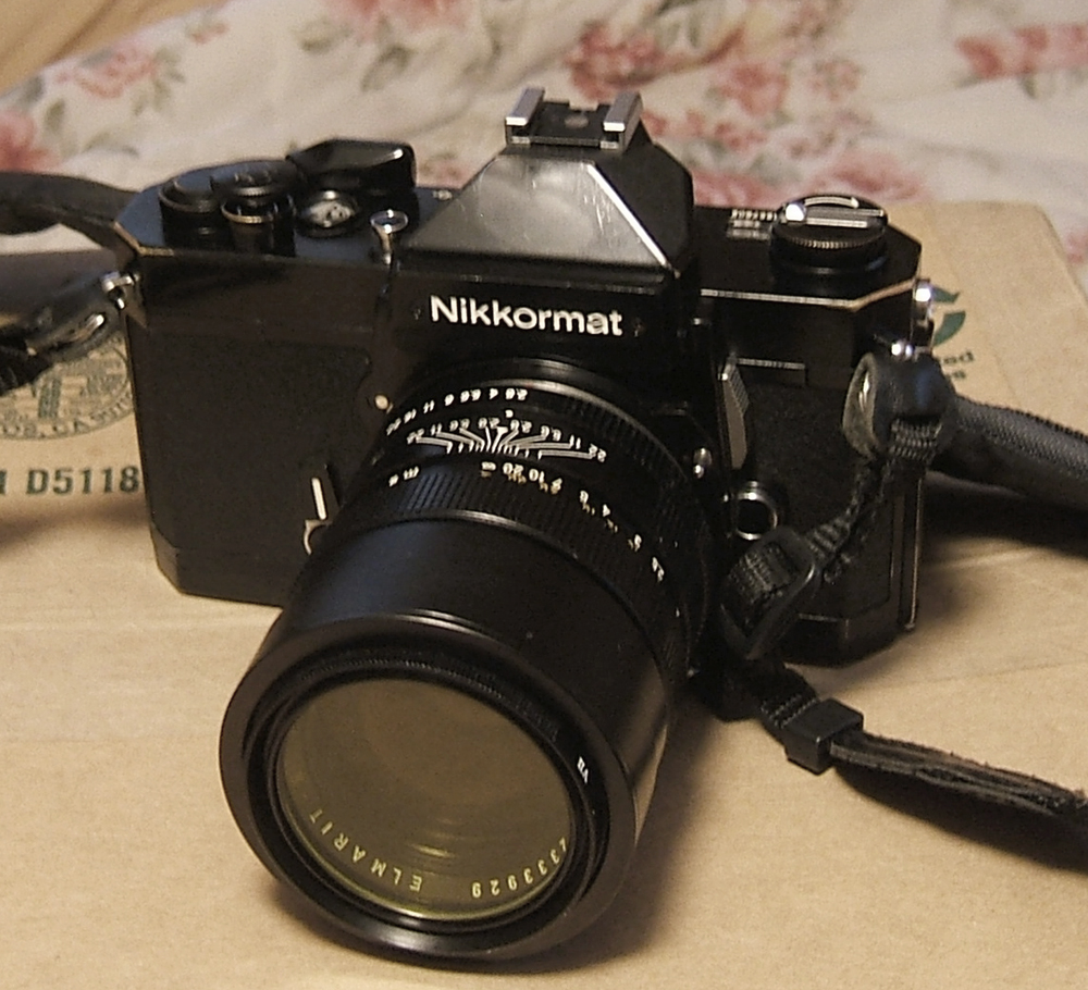

I have an old black Nikkormat FT2 that I really love. The speeds are fine, but above 1/125 they're at least a stop off. 1/1000 tops out at 1/400. I always shoot Tri-X w/ a yellow filter, which sorta helps, but I would like to get the higher speeds up so I could shoot w/ my one Leica lens at wider apertures. Is this something I might be able to do myself, or is it complicated? I'm somewhat handy, but have no experience on these cameras, other than getting into the lens mounts to fix the jumpy meters?

IF you havent repaired a few SLR bodies, be aware that the timing is controlled by springs and escapements. Cleaning them and oiling them correctly without bending things, losing springs and air thin shims is risky. I have never been inside a nikkormat but I have opened 5 or 6 rangefinders and several medium format cameras and wouldnt hesitate to try...
If I was willing to throw the camera in the garbage, that is. I never open a camera to repair it without that thought in mind.
If the camera is precious to you, send it to a pro.
By all means have your Nik'mat overhauled so you can use its full range of shutter speeds.
But don't count on using a Leica lens on it. The Nikon F mount's register is 46.5 mm. Leica thread- and M-mount registers are, respectively, 28.8 and 27.95 mm. Leica R-mount register is 47.0 mm. There's a bare chance that an R-mount lens can be attached to a Nikon and still focus to infinity, no hope at all with Leica rangefinder lenses. Leica RF lenses can be used on Nikons, but only for closeup work. Very close up.

Thank you. I was hoping the copal shutter might be somewhat simpler, but maybe not. I might just shoot it w/ a red filter, which would give me 2-3 stops, rate the film at 100, and be done w/ it. The last time I shot Tri-X at 100 it looked surprisingly good.
I've sent cameras out to be repaired w/ mixed results. Often the repairers tell me that on an old shutter, one stop variation is within spec, which is about where I am anyway. I've overhauled leaf shutters on Rolleiflex and folders, but they're obviously not a copal shutter. Maybe a work-around w/ the ISO and filter is safer, and for sure cheaper. It's a fine old camera w/ the nicest "snick" you ever heard when you press the shutter button.
My Leica lens is an R lens Dan. I should have noted that in the original post. It works in stop down mode on Nikons w/ one of those cheap $20 knockoff Leitax mounts on the lens. Anything to keep from having to shoot it on a Leica R body, all of which I've tried, and none of which are as nice as the Nikkormat, for me anyway.

Compared to a horizontal running shutter, the Copal square doesn't have any adjustment points.
They're self contained units. IE:low speed escapement,self timer and shutter are contained in the same modular unit. Biggest part was removing them from the body since there's no real access to the assembly.
The ones the shop I worked at were able to revived needed tweaking of the travel times.

Also: http://nikonrepairmanuals.blogspot.com/ As I remember, getting the shutter out of the camera is a fairly big job by itself. I 've done it exactly once, about 5 years ago - not to service the shutter but to remove a fragment of film.
I have removed and installed these shutters. It's not really so bad. Yeah it's a pretty total disassembly, but I was surprised how I could get the camera popped apart in short order. One of my Nikkormats, my FT2 I build out of a box of junk Nikkormats I stole off EBAY.

I would not attempt such a repair without a factory service manual.
CraigCamera, http://craigcamera.com/ , reprint 90211, original 27126 listed under the Photographic Literature link.
Factory service manuals are meant as guides for camera service engineers with the training,, tools, test equipment and knowledge to effect repairs, not the man in the street.

It is possible to strip the vertical shutters but not practical for a stop even if you have expertise buy a ND filter instead or get a junk one & swap modules if the shutter fails.
