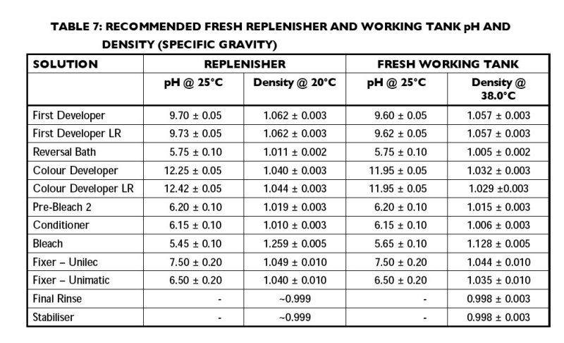

To the OP I think this is what you need:
Hope that is Ok
Mark Antony
