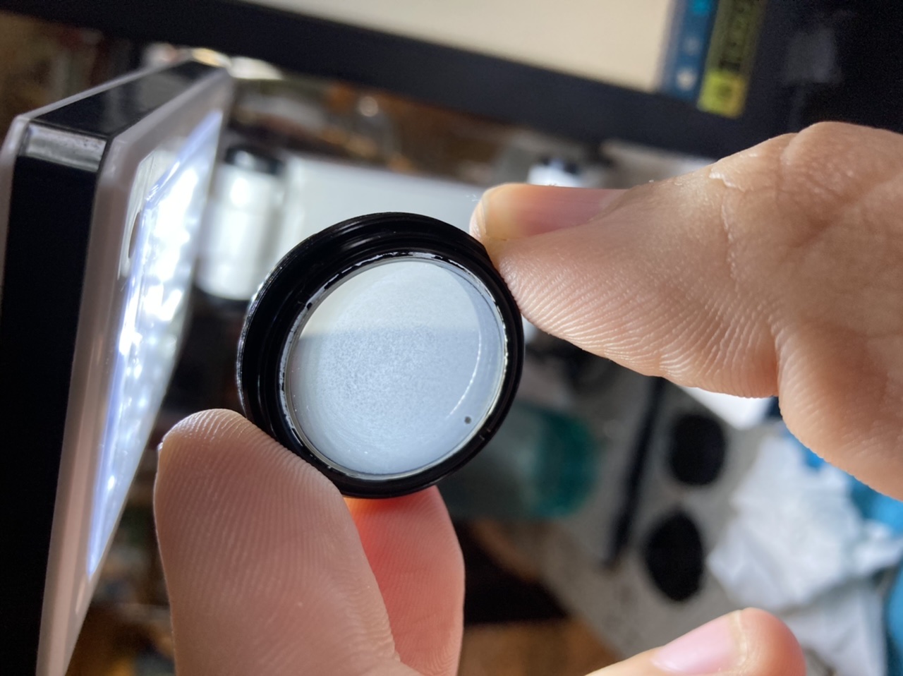

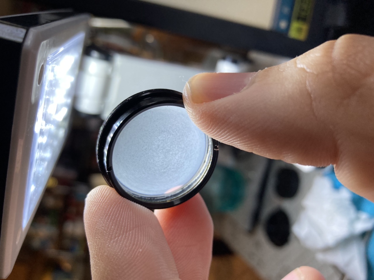

I found my canon 50/1.2 LTM in old camera bag, not used for more than a year. It didnt have haze last time I remember it, but now it has. I tried cleaning it with my breath and and a clean microfiber towel but it did not work. The haze is only on one side. Any other stuff I can try on this to clean it? I will try it with a roll of film and see if it is really bad, if not I might just live with it.

I got a Componon-S for $5 that looked like that. I t did clean up to be useable. I'm not familiar with that lens but you are sure it is not a doublet with a surface you are not cleaning.

I have a canon 50mm f1.8 ltm with similar on the inner element. Seems to be quite common with the canons.
I couldn't clean it, would need to be repolished with the right lens polishing machine if it could be cleaned at all. Probably better finding a new lens.
Don't leave lenses in the heat.

My guess is that it had it last time you used it, you just didn't notice. It can be hard to tell sometimes without pointing it into a bright light, and if you didn't notice before, it probably doesn't have a major effect on image quality. Though, in my experience, haze is the worst of the horsemen of lens Apocalypse (fungus, separation, and scratches being the other 3). Anyways, try cleaning it with the following:
- 99% Isopropyl
- 3% Hydrogen peroxide
- 5% ammonia
Not all together, one at a time. If none of those work, I don't think anything will, short of repolishing. Hydrogen peroxide can sometimes work miracles on fungus and haze, though.

Even at equal proportions it did nothing on my inner element, soaking for some days.. Worth a try though
Mine was etched in and only way would be to polish with the appropriate polisher.

I tried it with some 91% alcohol, no change at all. I think this is it for this lens unless I polish it. Test roll was a bust, first time using steel reels and it did not go well lol.

This, however, looks like buildup from outgassing, especially considering it hazed up in your bag. Makes sense that the alcohol wouldn’t work. Can you make a difference scratching the haze off with your fingernail? If so you can clean it off, and just need to find the right solvent. Acetone, denatured alcohol, naptha, etc. Try warm soap and water first. Use some slight pressure..

I have tried Eclipse and peroxide, no dice. I did try it and the haze is so bad its like I am taking pictures with a lens that has vaseline smeared in front.

Have you inspected the lens element surfaces with high magnification?
I had a lens with what I thought was coating haze, but the glass was actually micro-pitted.
It looked a bit similar to yours...shot a test roll, and contrast was un-usably low, very flarey.
You might want to check it under high magnification...(and report back!)

If it is a doublet, then there is likelihood it may have cement problems. About 10 years ago I wrote a tutorial for a friend in Romania and his site is still active: http://fotomozaic.ro/artikel.php?s=1&categ=0 It is in English and like nearly everything else I've written has been plagiarized greatly. This lens element repair uses Canadian Balsam. I've seen others use UV watch crystal cement, however you should understand if a mistake is made using UV crystal cement, your element might be ruined whereas with Canadian Balsam you can easily fix any mistake and the refractive quality is excellent. Jon

Looks like the coating got damaged due to oxidation or whatever chemical reaction. I've seen some elements like that:
- One inside my Mamiya Six rangefinder
- Another in some Mamiya tlr 180/4.5 lenses and Mamiya 135/4.5
(see a pattern??)
- Another in a Nikkor-H 300/4.5, element most close to the image plane.
- Many Olympus Trip 35 cameras i've seen with similar damage.
I think this is chemical damage or decomposition/degradation of the coating.
