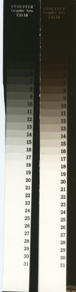

Pardon the ratty edges and the dust, but this is a quick a dirty scan. Both are MGIV WT developed in Dektol 1:3. The one on the right is a bleach/redev in thiourea. It looks tan with a hint of olive to me, but I guess everyone has their own definition. In prints made with this formulation, the shadows are very deep chocolate and midtones/high values to not go yellow
Is that the kind of thing you are looking for?

Doc...That's definitely in the range, particularly in the upper mids and highlights, but a bit too brown overall. If you don't mind sharing, what bleach and thiocarbamide solutions did you use? I'm assuming that it's a bromide bleach and I'm wondering how much potassium bromide to ferricyanide; same with the thiocarb, how many grams of hydroxide to thiocarbamide? I'm wondering if there could a be a way of getting upper mids and highlights like that but while retaining a bit more of a gray/black and white look through the lower mids and shadows - perhaps from a partial bleach or a short selenium before sepia. I also haven't printed with Dektol in years. That might be something to move back too, as well. Thanks for this!
Doc W
Nov 7, 2009
955
Ottawa, Cana
Michael, I am glad that this was helpful to you.
Indeed the prints that came out of this batch were very brown, which I was I wanted, but I felt that the tan might be of interest to you. I have the basic procedure and times in my notes but the bleach and the redeveloper were mixed by another APUGer, Hexavalent. He is going to add his data as soon as he organizes his notes (very shortly). We spend a lot of time in the darkroom together. He is the "chemistry expert."
- MGIV WT developed in Dektol 1:3 for 2'
- bleach for 5 minutes
- toned for about 3'
In that final toning step, the strip developed very quickly, in less than 30" if I recall. We really didn't need to leave it in that long.
Let's see what Hexavalent has to say. We might run a few more tests on this tomorrow.
...and here it is, basically Varigram 6B-1 Bleach and 6T-1 Toner:
Bleach:
Water, 750.0 ml
Potassium ferricyanide, 22.0 g
Potassium bromide, 25.0 g
Water to make 1.0 liter
Toner:
Water, 750.0 ml
Thiourea (thiocarbamide), 3.0 g
Sodium hydroxide, 6.0 g (caution: strong alkali that can cause severe burns - add to water slowly)
Method:
Prints should fixed in a non-hardening fixer bath.
Thoroughly wash the prints then bleach twice the time necessary (total 3-5 mins in the samples shown by DocW) to completely convert the black image.*
Then wash again until the image is free from the yellow bleach color.
The bleached print is placed in toning bath and left until toning is complete.
*Note: Different toning effects may be achieved by use of diluted bleach and 'pulling' the print before it has completely bleached.This technique can yield a split toning effect: sepia highlights with shadows retaining most of the native black tones.
