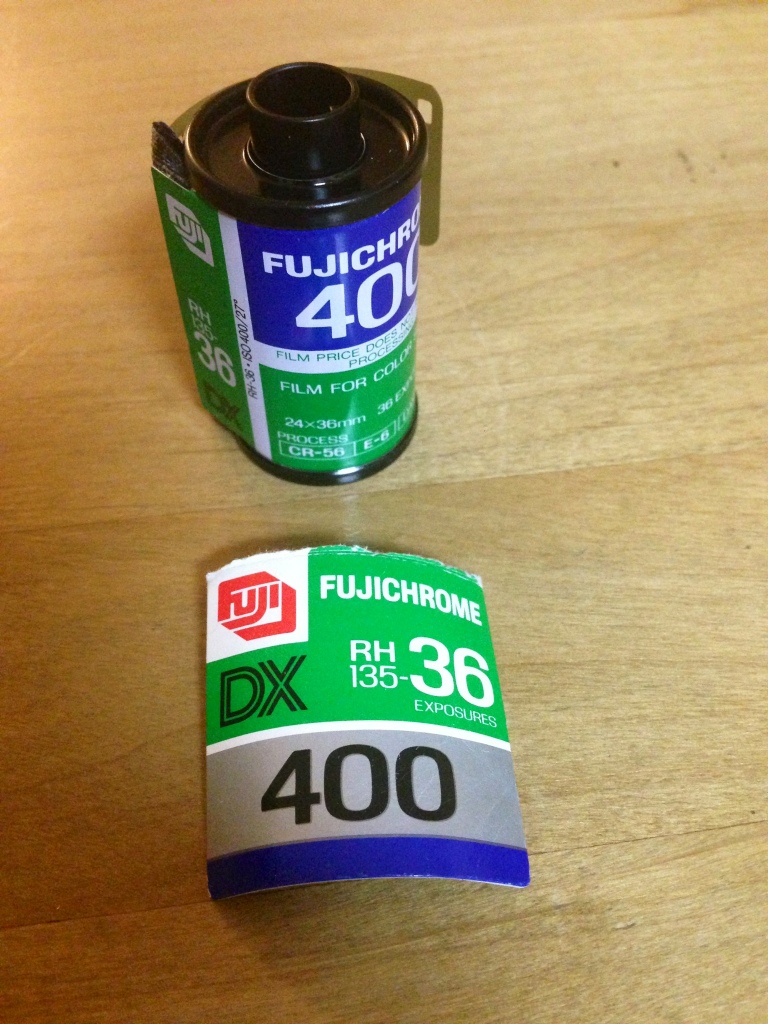

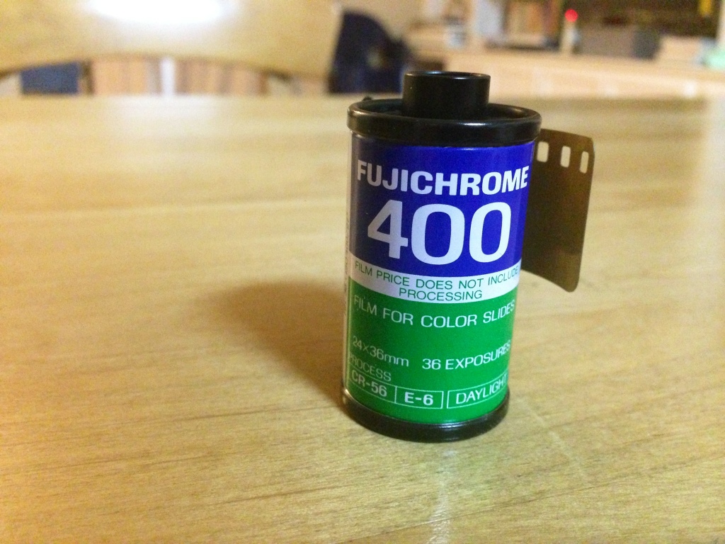

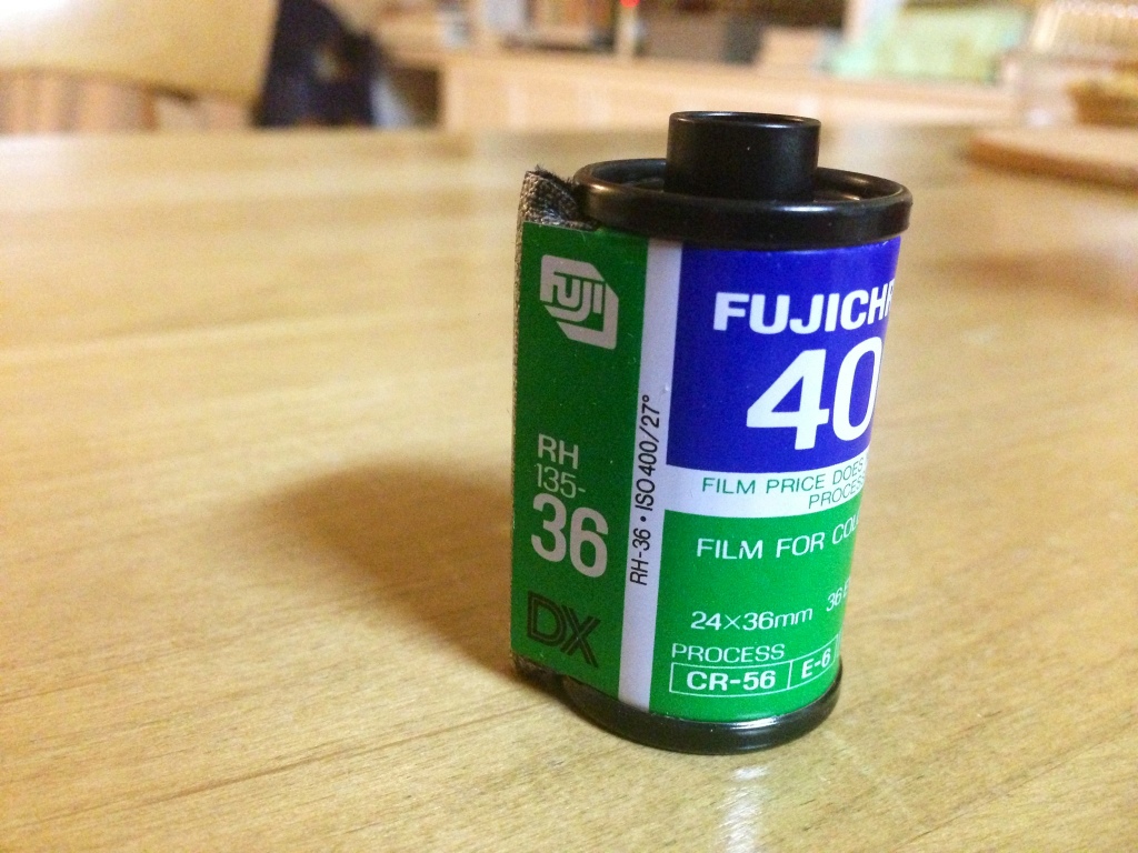

I got this 35mm E-6 film from either a friend or from eBay a long time ago. It has been sitting in my refrigerator for a long time.. On the canister is says Fujichrome 400 and I'm not aware of any E-6 ISO 400 film except Provia 400. So are they the same thing? Someone kindly explain this to me.
Thanks.
P.S. obviously expired. If I remember correctly the expiration date is 2005.

If you would re-label a film of yours for another market (-segment), would you give the re-labeled one the same DX-code?
andrew.roos
Jan 4, 2011
572
Durban, Sout
Quite possibly, on the assumption that consumers would not know how to interpret a DX code while it might be useful for photofinishers to know what film they were really dealing with. Of course APUG members are not generally typical consumers!
Mar 31, 2012
2,408
London, UK
That's how we can tell that Solution VX 200 is Lucky 200. They have the same codes.
GarageBoy
Nov 5, 2012
993
Definitely not RXP- that is an older Fuji logo from around the early 90s?
