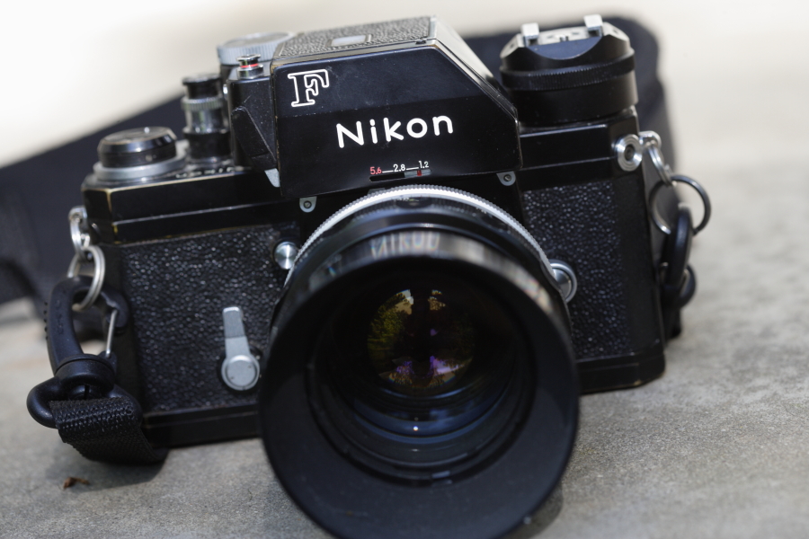

What ever happened to the days of a brassed nikon F and some camel non filters or a Cuban. web_Z7S2131.JPG
