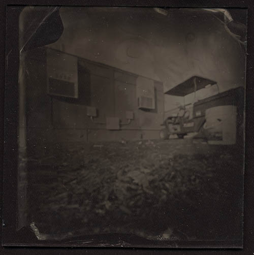

a sample image
Thanks for your reply. I have actually had some success making images. Here is a sample one:
-peri

The above is a ruby ambrotype on purple glass shot using a collodion containing cadmium and sodium salts. The large white streaks forming along the top and right edge are from the collodion becoming impervious to processing due to the collodion drying out rapidly. You can also see the thin border around the plate which is the albumen edge-subbing.
