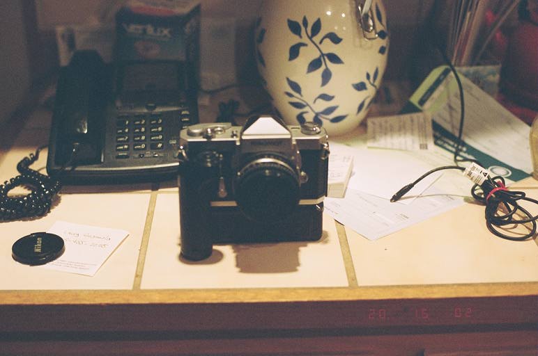

Anyway, I attached a pic of my chrome FTn with a MD-12 attached to it. Yes, the motor drive doesn't work on an FT series 'mat, but it sure makes a nice handgrip for use with longer lenses, like the 300f4.5 EDIF AIS Nikkor.
-J
