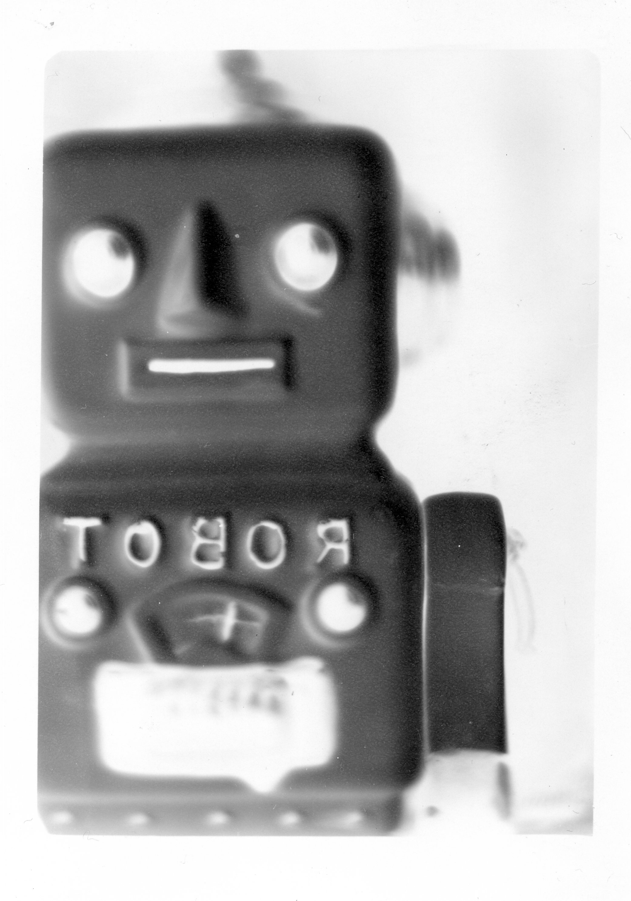

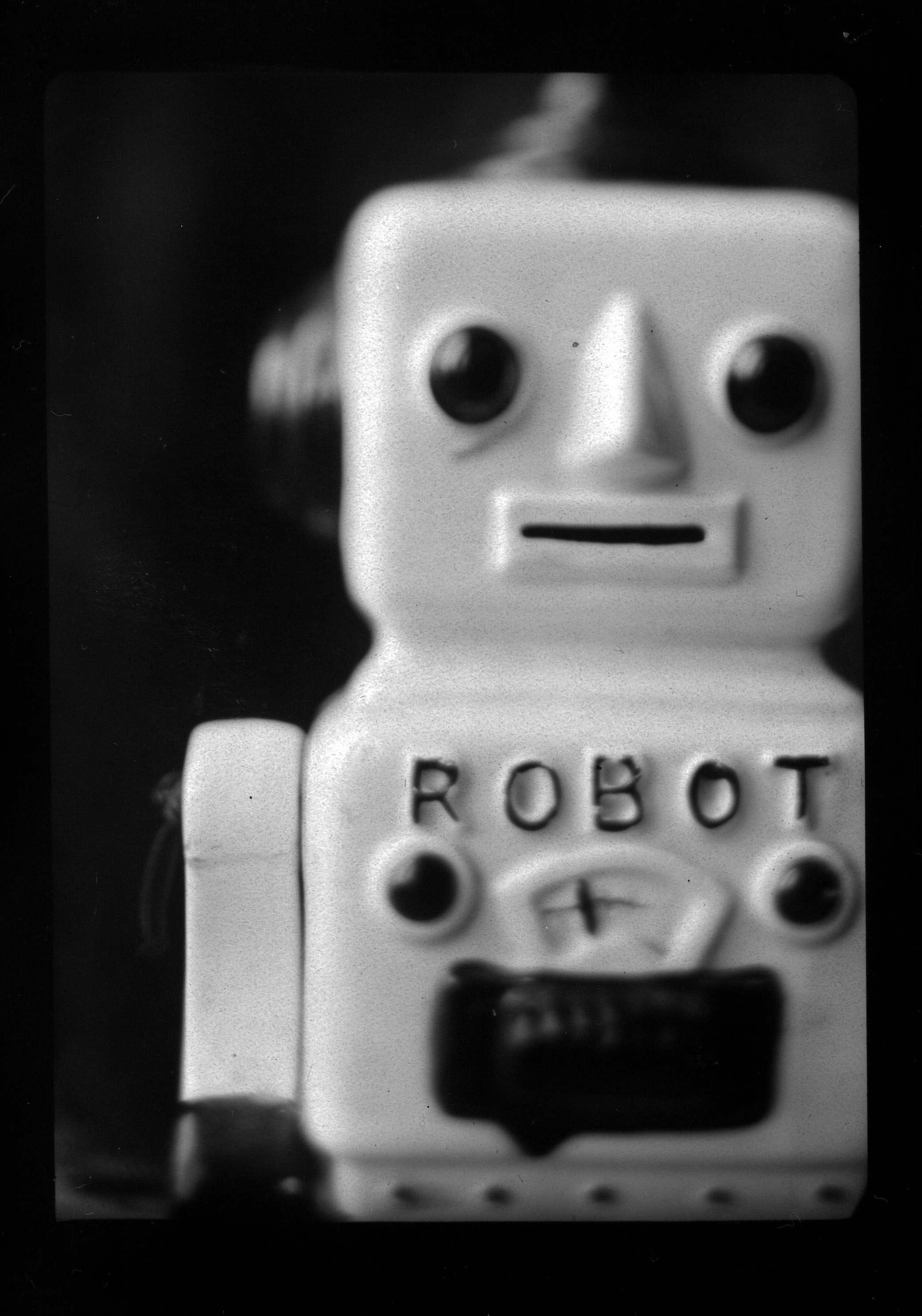

it finally worked ha-cha-cha...
the positive was inverted in photoshop for now, but I'm gonna try making a positive in camera later.
