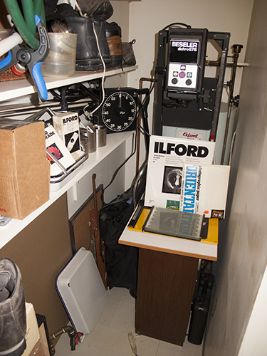

Here is mine set up in my bathroom/darkroom - it works well with a rollaway cart:

I can't imagine anyone thinking that even the single-column 67c is a "piece of crap" - it's a sturdy enlarger that's a great first-timer, and it's a good choice for people printing in kitchens or bathrooms and need to break their gear down after printing. I did many 16x20 prints with it, once I got it aligned.
