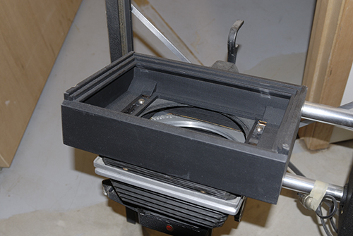

Here's a picture of a 5x7 conversion. The box seems to be a manufactured product.
