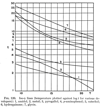

The main issue with very high or very low temperatures IMO is that you run into regions of non-linearity. E.g. take this often-cited figure from p.449 of Mees based on work by Ferguson and Howard in 1905:
What this shows is that the compensation for variations in temperature are non-linear to begin with (note the non-linear scale of the vertical axis), but that for some developing agents, the compensation factor even expressed as a log-function won't be constant across a wide temperature range. To make matters worse, the temperature compensation isn't the same for all materials (films, papers) either.
Within a reasonable temperature range and accepting a certain fudge-factor, tables like the Ilford compensation table/chart can be used. It won't be exact science, since as indicated above, 'it depends'. However, the question really is what level of exactness you're after. Personally, I wouldn't hesitate to develop my B&W film at 27C if that's the water temperature I happen to get out of the tap. I would do so in the awareness that my negatives would be a little 'off' - but that scanning as well as printing on variable contrast paper would allow me sufficient flexibility to deal with that slight problem. On the other hand, I'd hesitate to develop in temperatures significantly below the standard 20-22C: it's all too easy to heat half a cup of water so a jar of 20C can be mixed, and there's a limit to my patience waiting for my film to develop...All of which goes to show that IMO this is really a practical consideration for the most part, and not a very theoretical/fundamental one.
