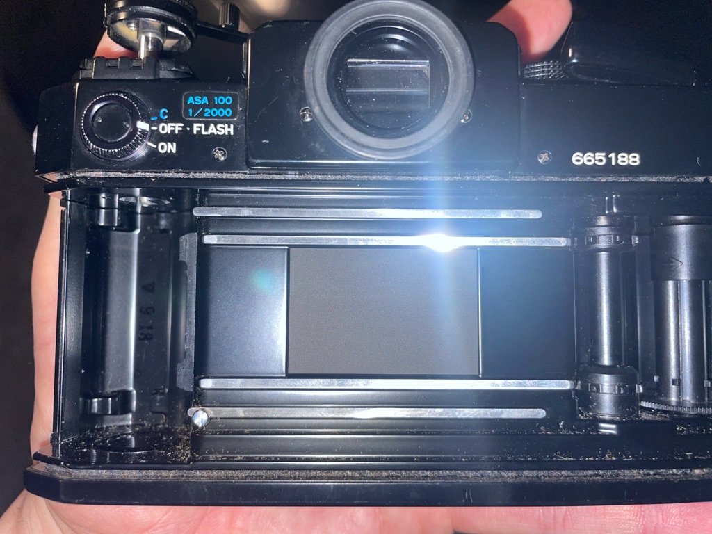

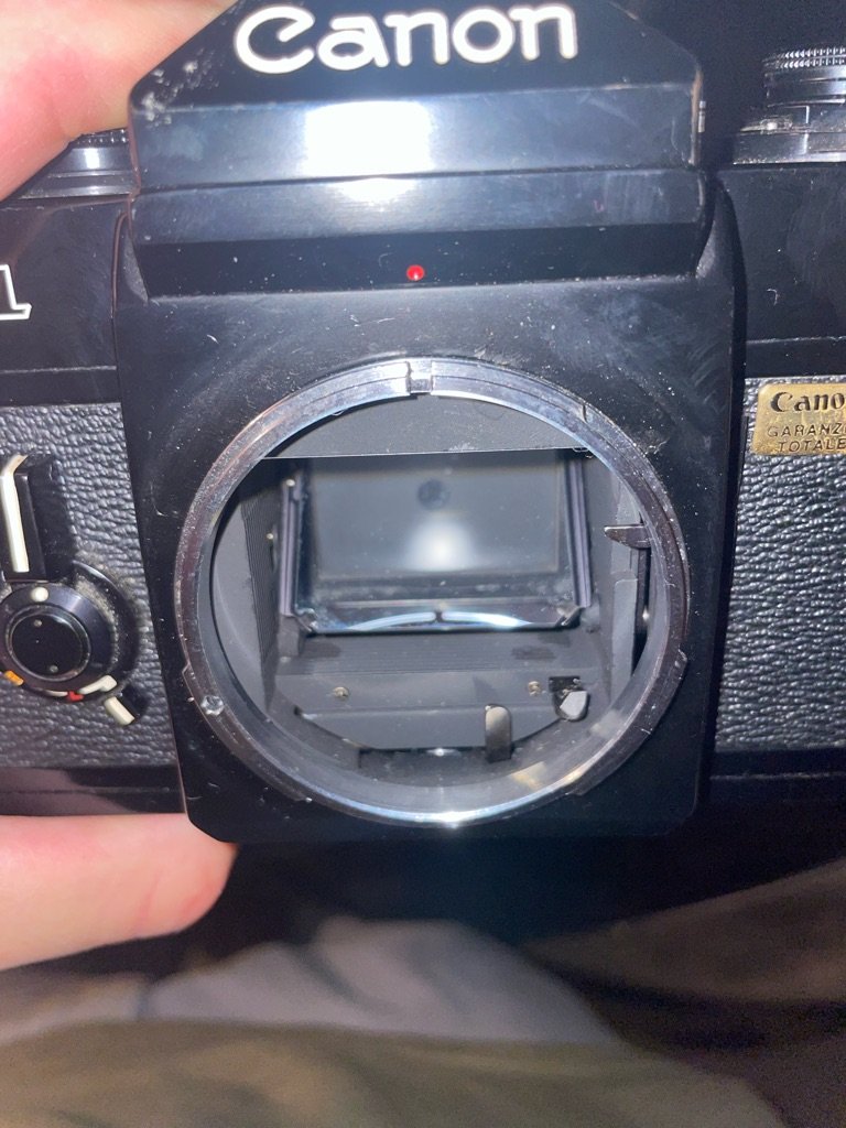

I can confirm the camera indeed works well, except for a very strange behavior that occurs once every 5/6 times only selecting 1/125 speed, in which the camera does expose correctly, but the mirror does not lower and the shutter seems to close almost completely but not quite all the way, as I said without leaving any parts of the film exposed. The mechanism resets when the advance lever is pulled. Do I have to worry?

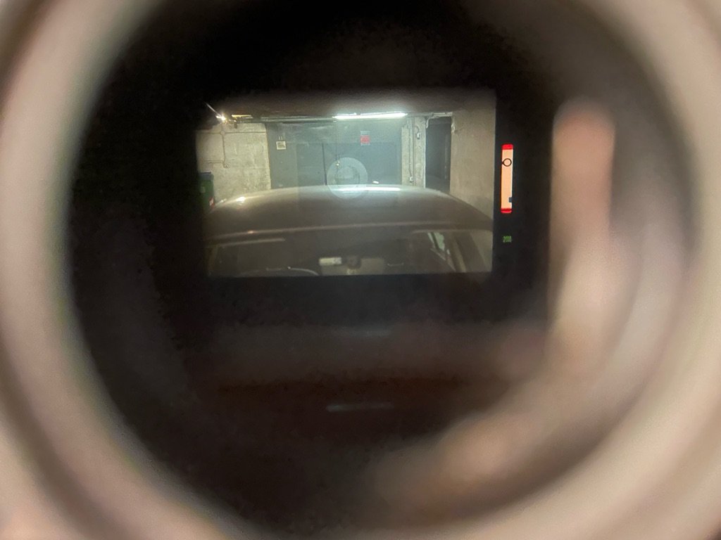

Apart from this the camera is in really good cosmetic condition but could use a focusing screen replacement. Is any of you selling one?
I don't know how serious that issue is, but I would absolutely get it serviced. I have an original F1 with gobs of beautiful brassing, and after a full overhaul, it is a pure joy to shoot with. Super smooth, with very satisfying sounds, and no hesitations/misfires/glitches. It's actually similar in weight to my Contax RTS III, which has a built-in motor drive!
