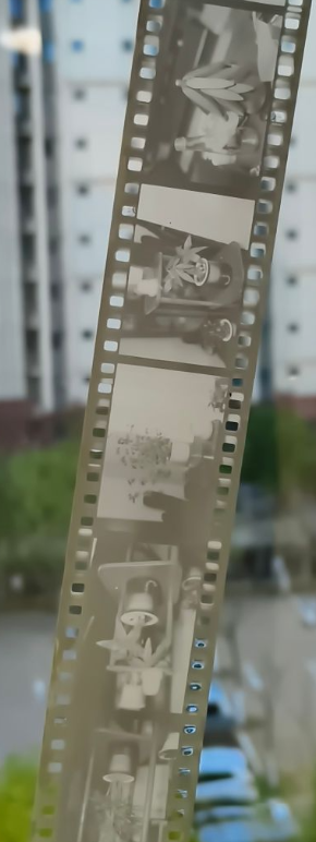

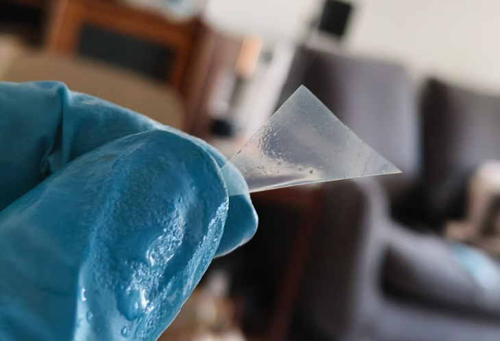

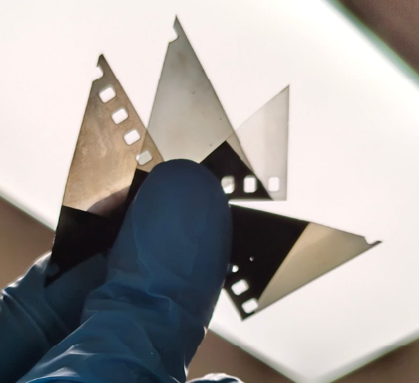

Here are two test film:
But:
1.Some iron staining after bleaching
2. After second developing, my Film reel was covered by some grey matter(silver?)
3.There are a lot of particles on my film, it's hard to be wash out, I use my figer to wipe it out.
4.I need to drop the film to cleaning bath without cleaning under water, or Fe(OH)3 will stick on the film, and can't not removed
So, Iron bleaching is a possible way, and it needs improvement.
Why do I know it can be improved?
Well, someone is selling a "NEW SAFE BLEACH", and it looks like this:
the color is exactly like my formula's!
But, it claimed that it's Acetic acid based, and it's PH value is 【0.2】! That doesn't make sense!

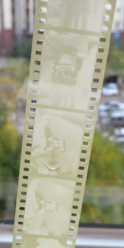

My bleach needs about 10min to sort of clean out the silver on the film, but the "SAFE BLEACH" I bought is only takes 5min( and it's already clean enought for me at 2 and half min!)
There is no silver particles stick on the film, and the film after bleach looks different
Mine bleach is white, with some grey.
while the one I bought is white, with some yellow(or green?)
I use the same film, and the same developing agent, cleaning bath(all from the "SAFE BLEACH" suit)
But, the one I bought seems much better.
I tested it on some films, the grelyish two in middle is the one I bought, the 1st and 4th one is mine.
Some info about this suit:
Bleaching: ph:0.2, 50ml solution is 58g
cleaning bath: ph:2.5
Anyone have any idea how to improve this bleaching method?

First, the PH value of the bleach I bought is 0.2---ZERO POINT TWO! That is crazy! I tried adding 20g Fe2(SO4)3 and add pure Acetic acid to 50ml, then I add water to 100ml, I only got about 0.8. I don't know what did he do to get 0.2.
Also, there is an interesting thing: the bleach came as a concentrated solution in about 270ml, and add water to 500ml for use. But other concentrated solution, like developing agent, cleaning bath, are all 36ml to 500ml, so I guess the bleach is REALLY high concentration?
About the photos, the first two (next to "Here are two test film:") are after bleaching but before redevelopment, yes. I did some test with some film leaders. The 1st photo is a film leader that I submerse half into developing agent, then put into the bleach, so you might see the right half is clean(been bleached) while the left remain the original film emulsion。 The 2nd photo is a film leader that fully developed and bleached, but before cleaning bath and redevelopment.
I found that Fe3+ bleach is less harmful to the film, I bleach for 15 minutes, and the film looks totally fine.When I use KMnO4, however, 5min will break my film.....

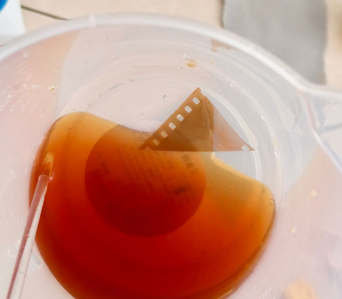

I forgot to wash my film after 1st dev, and bleached for 5min, then I found the KMnO4 turn from purple to clear, so I mix a new bleach and bath for another 3min...

I suppose the problem in this case has been that you forgot to wash: so residues of the alkaline developer could have increased the pH value of the bleach bath. But then the bleach can no longer work correctly.
I noticed this in the case of a worn out bleach bath: After five minutes, everything on the film was still dark brown. As it was only a short test film, it was late in the evening and I was too lazy to prepare a new bleach bath 😙, I simply added a little sulphuric acid to the bleach and then bleached the film again for a few minutes. Result: The film (Fomapan R100) was lemon yellow 👍.
In your case, the total of 8 minutes in the bleach bath may simply have been too much for the Lucky 400...

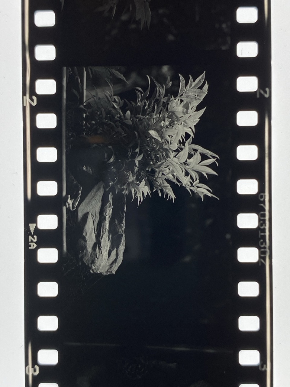

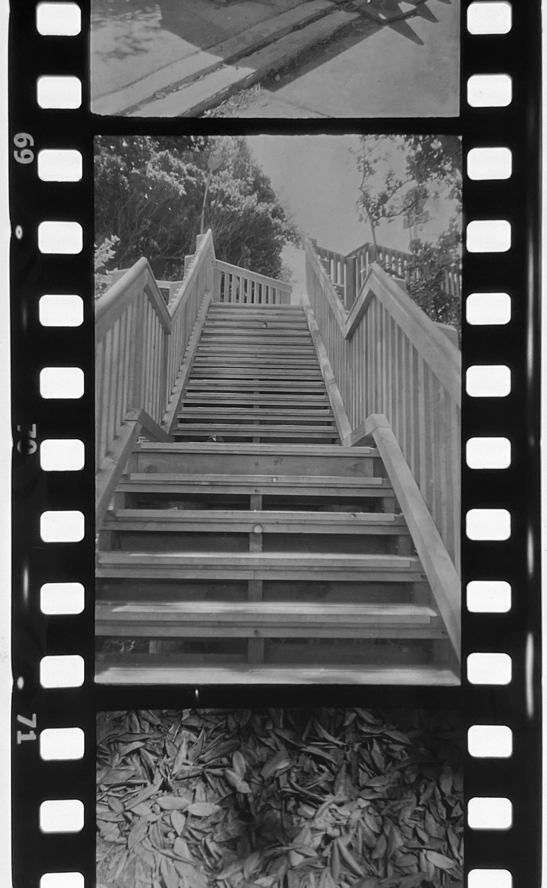

I tried some B+W reversal a year or so back, following some guides from people processing 8/16mm movie film as a starting point. I really need to do some more messing around, but I got some passable results.
Here's some notes I took of what I did (rather than necessarily what you should do).
B+W Reversal
Step 1
Developer: Rodinal 1+25 - needs to be a “dense negative”. All films should be the same time (like colour neg)
Step 2
Bleach: 250ml Hydrogen Peroxide 3% + 15ml White Vinegar (should be run warm / hot, but take care not to “shock” the film with a big temperature change. Run for at least 6 minutes. Longer doesn’t hurt. Solution can be re-used, but leave space in container as it can expand.
Step 3
Expose film to light
Step 4
Re-develop, can use developer from step 1. Develop for normal time, though you can’t really over-develop at this stage.
Step 5
Fix as usual
Step 6
Rinse as usual
Rollei Retro 400s at 200
  1. Develop in Rodinal 1+25 @23c for 15 minutes
  2. Rinse / soak 10 minutes at 25c
  3. Bleach @30c for 15 minutes
  4. Re-expose 2-3 minutes
  5. Re-develop in Rodinal 1+25 15 minutes
  6. Rinse
Normal development time for Rollei Retro 400s is 10 minutes for Rodinal 1+25. Perhaps try shooting at box speed and doing first developer for same 15 minutes at 23c.
Fomapan 100 at 100
  1. Develop in PC-TEA 1+30 @25c for 12 minutes
  2. Bleach for 20 minutes @30c
  3. Re-expose to light (bright bulb) 2-3 minutes
  4. Re-develop PC-TEA 1+30 @25c for 12 minutes
  5. Rinse
My notes says these came out looking OK.

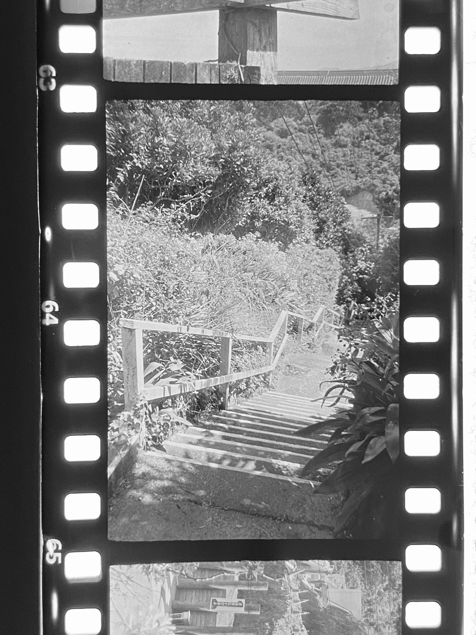

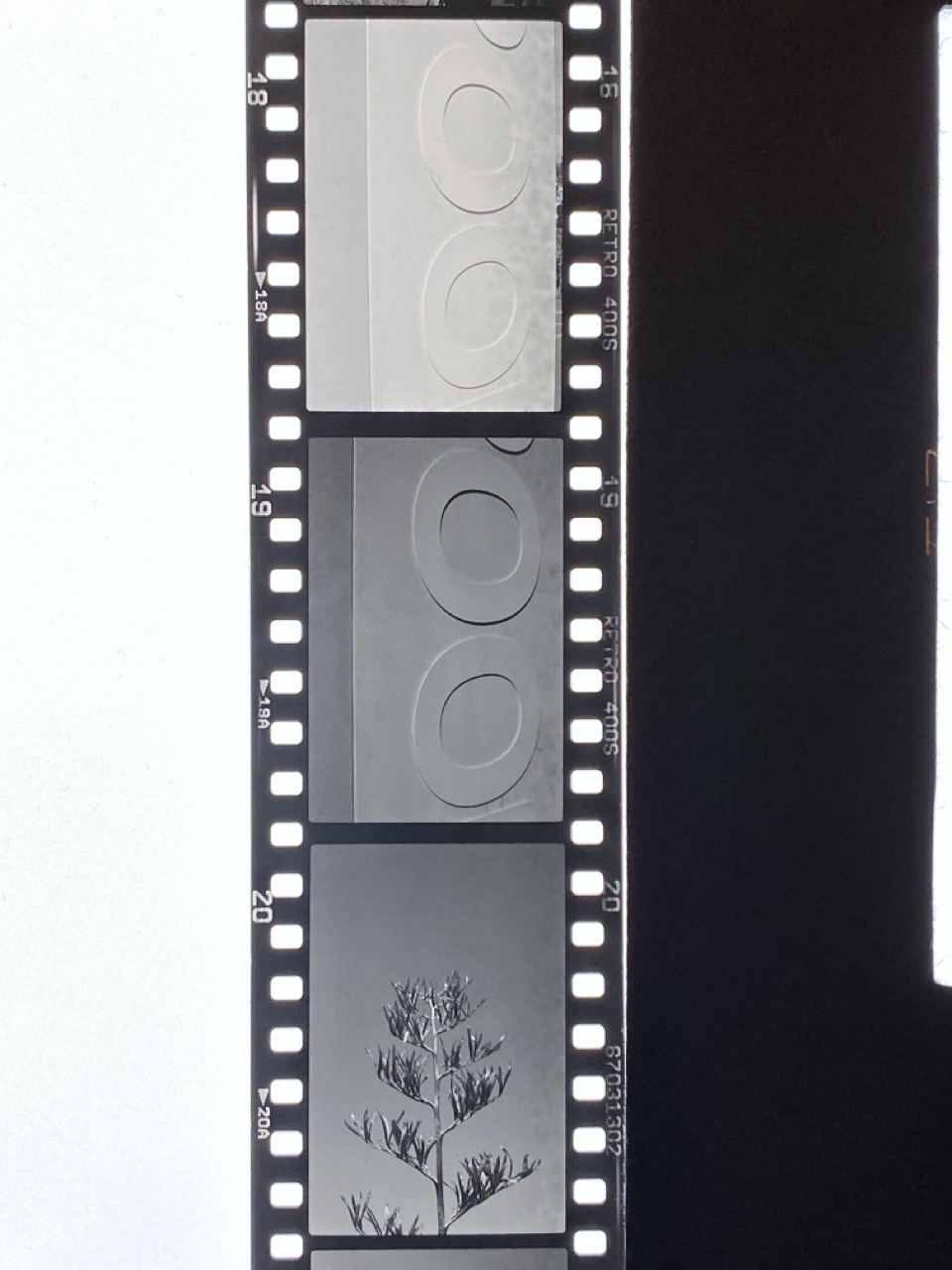

Attached are some iPhone "scans" of the results, straight colour shots (i.e. not converted to B&W on the phone). The Foma ones have a very slight brownish tinge, the RR400s are nice and black
The stairs are from the Fomapan in PC-TEA (with a Ricoh 500G that needed some new light seals), the others from the Rollei Retro 400s in Rodinal 1+25 (Fujica STX-1N). Any bubble marks on the frames are of my own carelessness!

It's kind of expensive; >€1/g in quantities that would make sense for a home darkroom user. It may be challenging to get hold of it.
I know that Cerium(IV) can work as bleach, as in this article https://unblinkingeye.com/Articles/NDICRB/ndicrb.html
but, what I don't understand is, why do we need Fe3+?
koraks
Nov 29, 2018
23,106
Europe
We don't.
I linked to two patents, and they're quite different in how they propose to use cerium.
The Konica-Minolta patent uses DTPA as the bleach, but notes that this involves problems with yellow staining of the film. They propose to use cerium (or another lanthanide) to promote oxidation of Fe(II) back into Fe(III) so that very little/no Fe(II) is available to stain the film. I suppose cerium (or another lanthanide) is present in its capacity as a catalyst here, and the concentration might be quite low. The cerium as such is not there to act as a silver bleach, per se.
The Fujifilm patent does use cerium (and only cerium) to bleach the film, but notes that there are some limitations/drawbacks w.r.t. its efficacy and levels of fog. The patent I linked to explores in particular the bleach accelerator that make the cerium bleach faster and cleaner. Unfortunately, the crucial bits of the patent (i.e. the key of which compound is used for which accelerant test) is missing from the patent text, rendering it impossible to determine which compound made for the best accelerator. This may or may not have been cysteine.
Coming back to your original comment:
the bleach I bought, one said that it also has cerous, not just Fe3+。
I suspect that your bleach may have a trace amount of cerium(IV) to prevent staining that would otherwise occur due to the formation of Fe2+ as Fe3+ steals an electron from Ag to form Ag+. Mind you, I don't know the makeup of the bleach you've got there, so I don't know for sure. The amount of cerium present would be a good indicator of what it's there for.
Ausar
Oct 12, 2024
18
China
We don't.
So, Fe3+ is used for making Ag to Ag+, but Fe3+ itself will be changed to Fe2+, which is bad, because it will be hard to clean(like in my experiment).
So, adding some cerium(IV) will turn the Fe2+ back to Fe3+, problem solved?
koraks
Nov 29, 2018
23,106
Europe
That's the gist of the Konica Minolta patent, yes. Does it work as simple as you just said? I don't know; the trick with patents is of course to accurately describe the invention so it's legally protected, but not as accurately so as to enable others to duplicate it...
lamerko
Oct 27, 2022
759
Bulgaria
Why not try thiourea toning and rehal bleach? True, it won't have that beautiful black, but still beautiful...
koraks
Nov 29, 2018
23,106
Europe
what is rehal bleach? sorry I don't quite know what it is
"Rehal" = rehalogenating.
The idea is that you develop the negative image in the usual way. Then you fog all remaining silver halide into silver sulfide using a thiourea toner (sodium sulfide / polysulfide toner will work, too). Afterwards, you bleach the original silver negative image using a rehalogenating bleach. This can be for instance a normal ferricyanide + bromide bleach. Finally, the silver halide negative image is fixed out.
The advantage is that this can be done with quite ordinary chemistry and the process is easy and robust. The drawback is that the silver sulfide image will be brown to yellow in color. It's not possible to obtain a neutral greyscale image this way. If you like sepia toned slides, this approach works great, however.
Ausar
Oct 12, 2024
18
China
Oh, I heard of something about rehal, it's kind of easier, because AgCl、AgI or something like that is hard to dissolve, so the chemical reaction is easier to make.
But what I don't know is the toner's formula, I mean, I did hear that SnSO4 can act as a chemical reversaler, but someone said that it can't turn [all the remaining silver halide].
Can the toner you mention do the trick? Any formula I can get?
koraks
Nov 29, 2018
23,106
Europe
You're mixing things up now, I think.
Tin(II) chloride is often used as a fogging agent, taking the place of a fogging step done with light. This simply exposes (renders developable) the silver halide in the film.
What I'm referring to is a thiourea toner, which acts on silver halide, regardless if it's exposed to light or not (it's not selective).
It'll convert any silver halide to silver sulfide, regardless if it's exposed or not. The process suggested by @lamerko above hence does not require a fogging step.
Make one solution of 4% thiourea, and another solution of 4% sodium hydroxide. Add 1ml of both to 100ml of water. Use one shot. This should get the job done.
By varying the ratio thiourea to hydroxide, you can shift the tone to more yellow (less hydroxide) to brown/purple (more hydroxide).
relistan
Sep 1, 2013
1,591
Dublin, Ireland
My suggestion would be to iterate on what you are already doing @Ausar . You have something that is headed in the right direction. Try using citric acid instead of acetic acid. In all the testing I did, I found that citric acid sequestered more silver than I was able to get acetic acid to do. It will stain, however, (forms silver citrate) and requires a clearing bath like the one you are already using. Additionally, having read a lot of patents, most target pH values are like I said, in the range of 2-4 for effective bleaches. I don't think I'd want either my film or my tanks in pH 0.2 soup, never mind my extremities.
