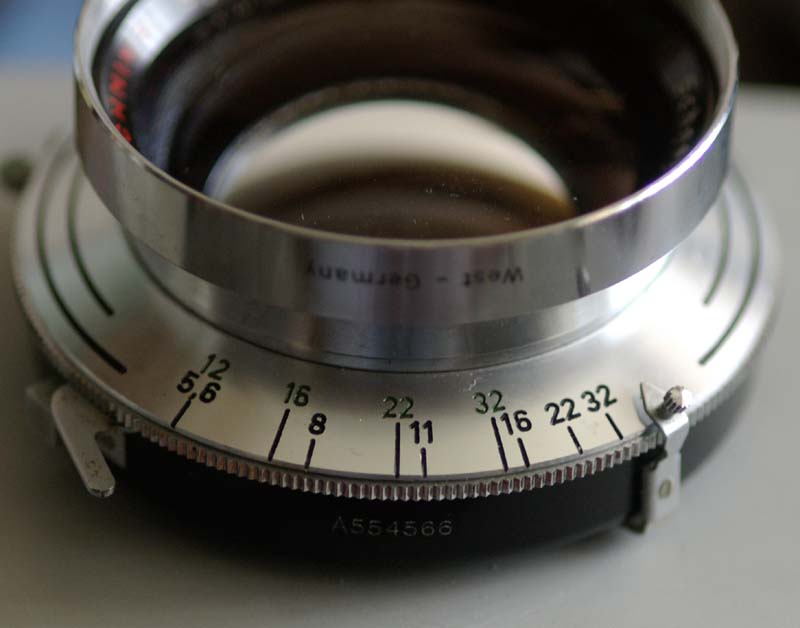

Here's the scale on my Linhof version of the 210/370 convertible. In this shot the aperture arm is at full travel. At f32 on the 210 (black) scale the apparent aperture size is 12.5mm while at f32 on the 370 (green) scale the apparent aperture size is 5.5mm. At f5.6/f12 the aperture is wide open.
Hope this helps,
Paul

Hello !
I've one Symmar 210 in it's original Compur Electronic shutter.
The iris scale is labeled 5.6 for the 210 lens, and in exact correspondence 12 for the 370 lens.
All markings are lined up all way from 12 to 64. (this left the 2 extreme positions unmatched, I think Schneider thought that going at 90 or 128 with the single cell 370 was not a good idea)
BTW, the scale is with click stops at 1/3 of a stop interval
So the scale reads
5.6 8 11 16 22 32 45 64 for the 210 and
12 16 22 32 45 64 for the 370.
Hope this helps !
