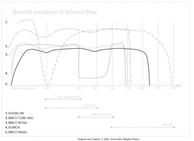

It wouldn't be possible to tell unless you tried them side by side. I would recommend buying some and trying it. From what I understand the Aura lacks the antihalation treatment, same as the Kodak HIE. So much of the look could potentially be retained. But the spectral sensitivity is different, please see the attachment.

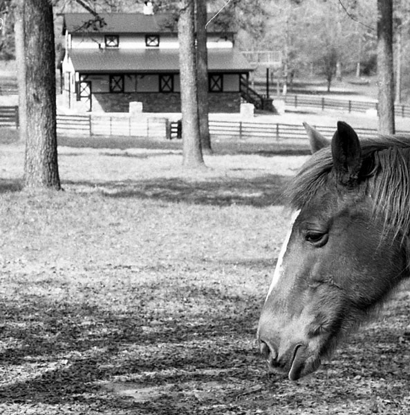

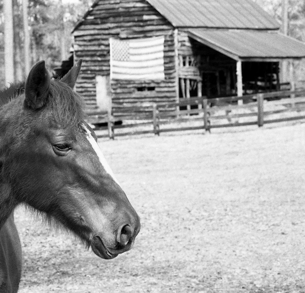

Thanks, Thomas. I did buy three rolls of 35mm to do exactly that. The next two will be in Rodinal 1:25 or 1:50 and Beutler 1:1:10. The only pain in the butt is that it really is a dust magnet. I use a drying cabinet and even then I have dust on some frames that I have never seen before. Also, delicate emulsion, and prone to scratches if not handled very carefully.
Maximus great shots! I have 4 rolls if HIE left and that is the "Standard" for IR but when it's gone it's gone! I am trying to see what I can get out of the EFKE 820 Aura. It is smoother than HIE but I like it. The SFX is GREAT B&W but not much as far as IR in my opinion.
Here are a couple of shots with SFX with no filter.
