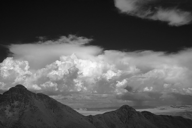

Personally, I have not invested in a DSLR conversion yet. I use a really conservative (and affordable) setup. I have a Nikon D70, which is an old 6 mp camera whose sensor is known to have a weaker IR blocking filter than later DSLRs. I use manual focus lenses with an IR focusing mark and that don't have central hotspots. The Nikon 28/3.5 has given me good results, for example. I have a 720nm or 760nm filter and exposures in full daylight are about 1/2 sec, which obviously means I can't handhold, but I can set the camera on a rock or fencepost and trigger it with the self-timer or a remote. The results are somewhat like Kodak HIE in tonality, so I don't think you need to go all the way to an 850nm filter to get the B&W IR look. Here is an example photo with this setup:
Cloudbank, Arizona, August 2019
by reddesert64, on Flickr

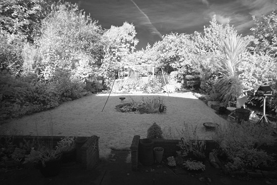

Sigma SD 14 and 15 have removable IR filters, I have a few shots banked, need to find the right memory card, but take a look at these and link to discussion below. Not sure if the new Sigma mirrorless bodies have removable filters, for that matter or the SD1 .
https://www.dpreview.com/forums/thread/4213182

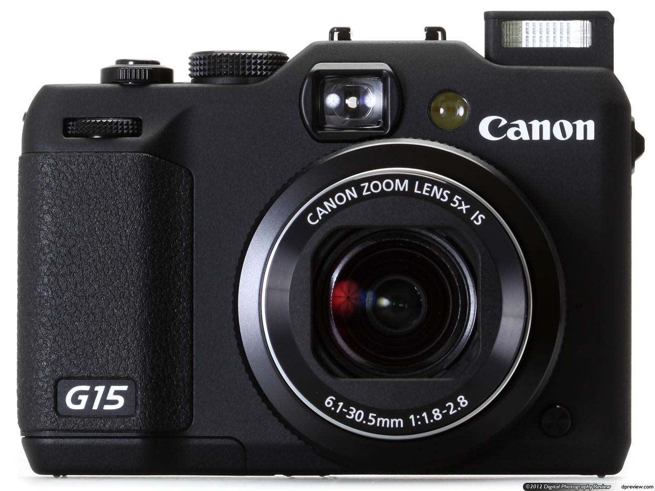

I found this on google, https://kolarivision.com/product-category/cameras/
Don't know anything about the company, but if still in business might be what you are looking for. The Sigma SD 14 and 15 the image has to be converted to a grayscale in PS or Correl. They seem to have a wide range of converted cameras. Dont know if they shoot grayscale or color.
Infrared Conversion Used Canon G15 Infrared Converted Point and Shoot Camera
