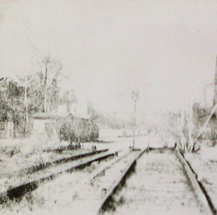

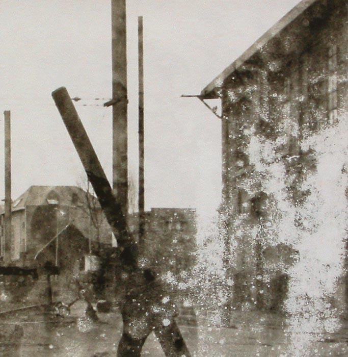

Here are a couple of images I artificially "aged" using a dilute solution of household chlorine bleach. I sprayed the bleach, then stopped the process by spraying water.
