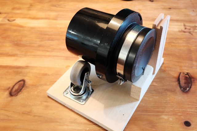

I did use the original Lab-Box, the Rodinax 35U tank, and it offered good results. I even had it motorised which is smoother than the specified stop-and-go half-turns. No development drag.
Nowadays I have a DIY horizontal tank rotator jig, but just for the fixing stage. Allows for 50% less fixer usage. Added a motor since then.
DSCF7504 by Olivier, on Flickr
