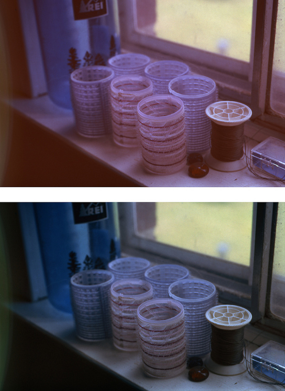

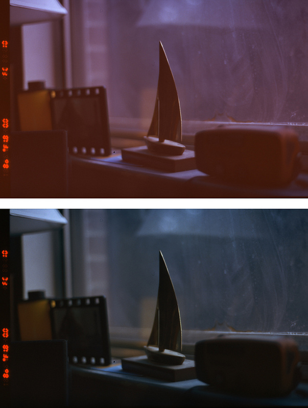

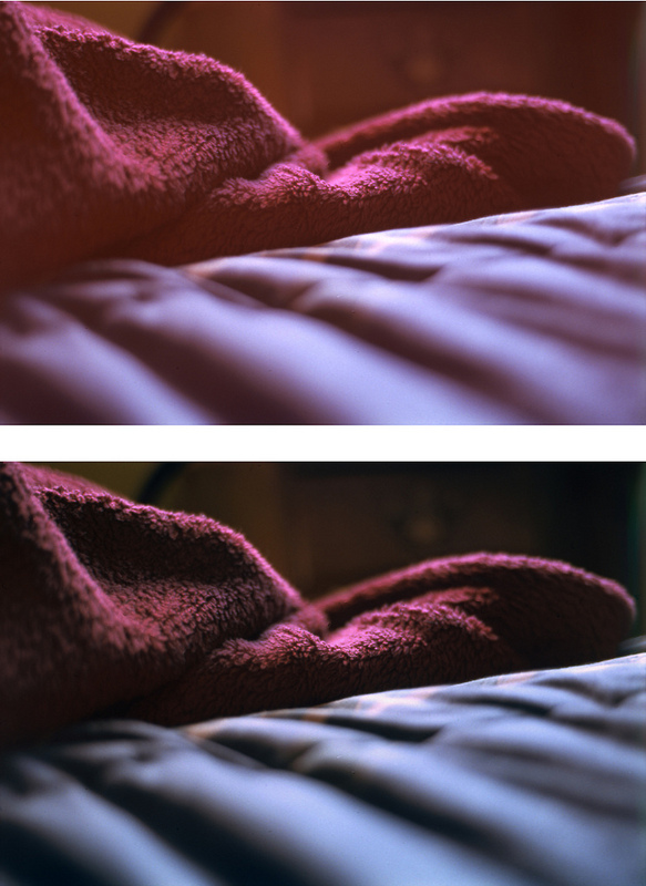

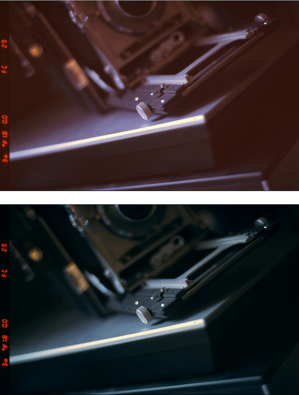

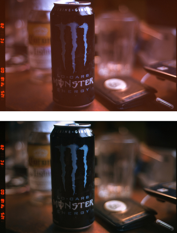

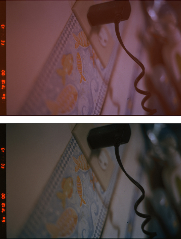

I've been wanting to try cross processing C41 film in E6 chemistry for a while now, and I finally did it... Apart from the fact that there's an orange base and you seem to lose 2/3 to 1 stop of light processing it as color slide (may be a visual effect of the dark base?) Kodak Portra seems to hold up remarkably well with regards to color rendition for a cross processed film...

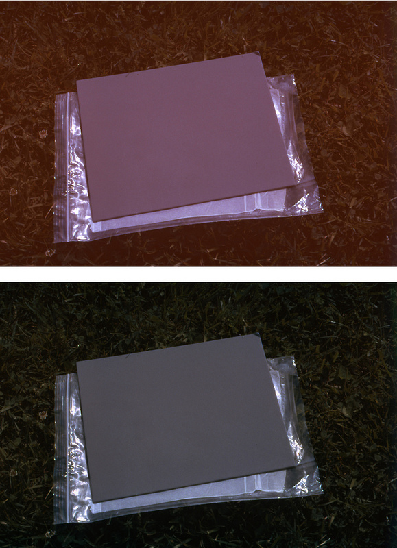

Which got me thinking... What if Kodak offered Portra 400 on a clear base, specifically for this purpose? I photographed a grey card and made a custom curves adjustment from that photo in an effort to simulate what the colors would look like if the orange base were not present. The following images have not been manipulated in any way other than the color correction, I haven't even sharpened them or spotted them for dust...
7143018707_79d50236ed_c.jpg 7143010745_75b8df09bf_c.jpg 7143002191_659fe04289_c.jpg 6996906970_1d38077746_c.jpg 6996899102_3a1706270f_c.jpg 7142979239_01db865f04_c.jpg 6996882320_6a55520e3f_c.jpg 7142958223_c064623e24_c.jpg
Yes, I realize there may be some innate flaws with what I've done, but it does get you thinking... I do like the color palate, and it still has pretty decent latitude. Also, How many lower contrast slide films are out there now?
Again, these could all benefit with some more exposure and maybe contrast, but the goal here was to do as little adjustments as possible. I don't know about you, but Portra 400 on a clear base seems like it would look pretty nice.

Am I the only one that thinks Portra on a clear base would be a good idea?

Oh hell I like crossing but it's usually the other way around for my tastes.
My favorite E6 in C41 soup is Kodak EPP.
Crosses just enough without being too terribly garish.
Plus the fact that around my place E6 soup is precious stuff so I tend to use it for E6 materials.

It looks pretty good to me. If that were my only option for reversal film I would use it (with the clear base I mean).

Very nice results. I don't think that they would re-engineer Portra though for such a tiny marked. It is a big change. That is not "colored base" and so you don't just change to clear base. That is a positive orange image superimposed on the negative image and which corrects color impurities. Changing it would be a huge job.
