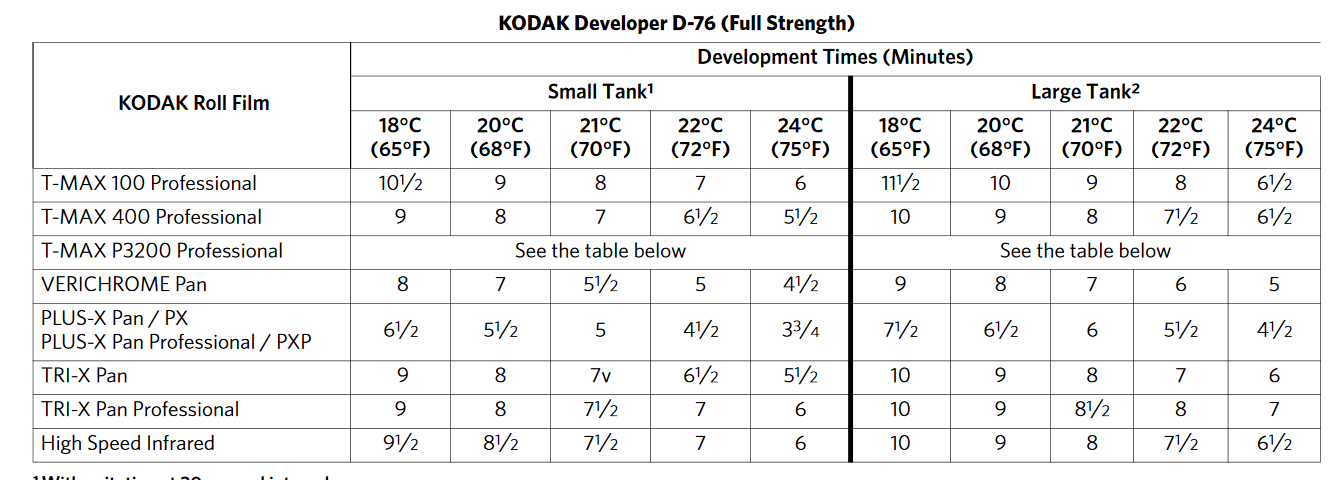

@ADOX Fotoimpex Why do you list a time of 7 minutes for TRI-X 400 film with Adox D-76 CLASSIC, whereas Kodak lists a time of 6 ¾ minutes for TRI-X 400 film with Kodak D-76 developer?
Kodak is a bit unreliable in their times. From their 2017 D76 data sheet:
I particularly like the time for TriX Pan at 21 degrees.
The TriX data sheet also says 8 minutes at 20 degrees.
