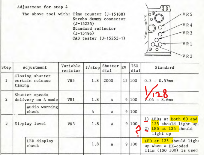

I'm looking at the official repair manual for my Nikon N2000 (F301) and having some trouble understanding what Nikon is saying.
On Step 3 there's two standards and I don't know how to adjust. BOTH 60 and 125 lighting up and just 125 lighting up. Followed by just 125 lighting up with DX film with the same settings otherwise. Does anyone know how both 1) and 2) can apply at the same time on Step 3? Should I just adjust it until only 125 lights up?

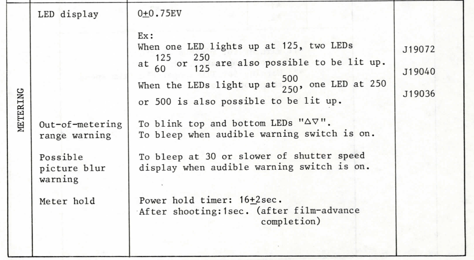

I interpreted that as the tolerance, which is +/- 0.75EV. I think they are indicating that either 1) or 2) are OK.
I have three of these n2000 and I just checked them again. They show "125" but the "60" occasionally blinks with the light source at EV9.
I also see this as an indication of a tolerance range of half an aperture stop.
In practice, this shouldn't make a difference, but if it does, it can be adjusted here.
