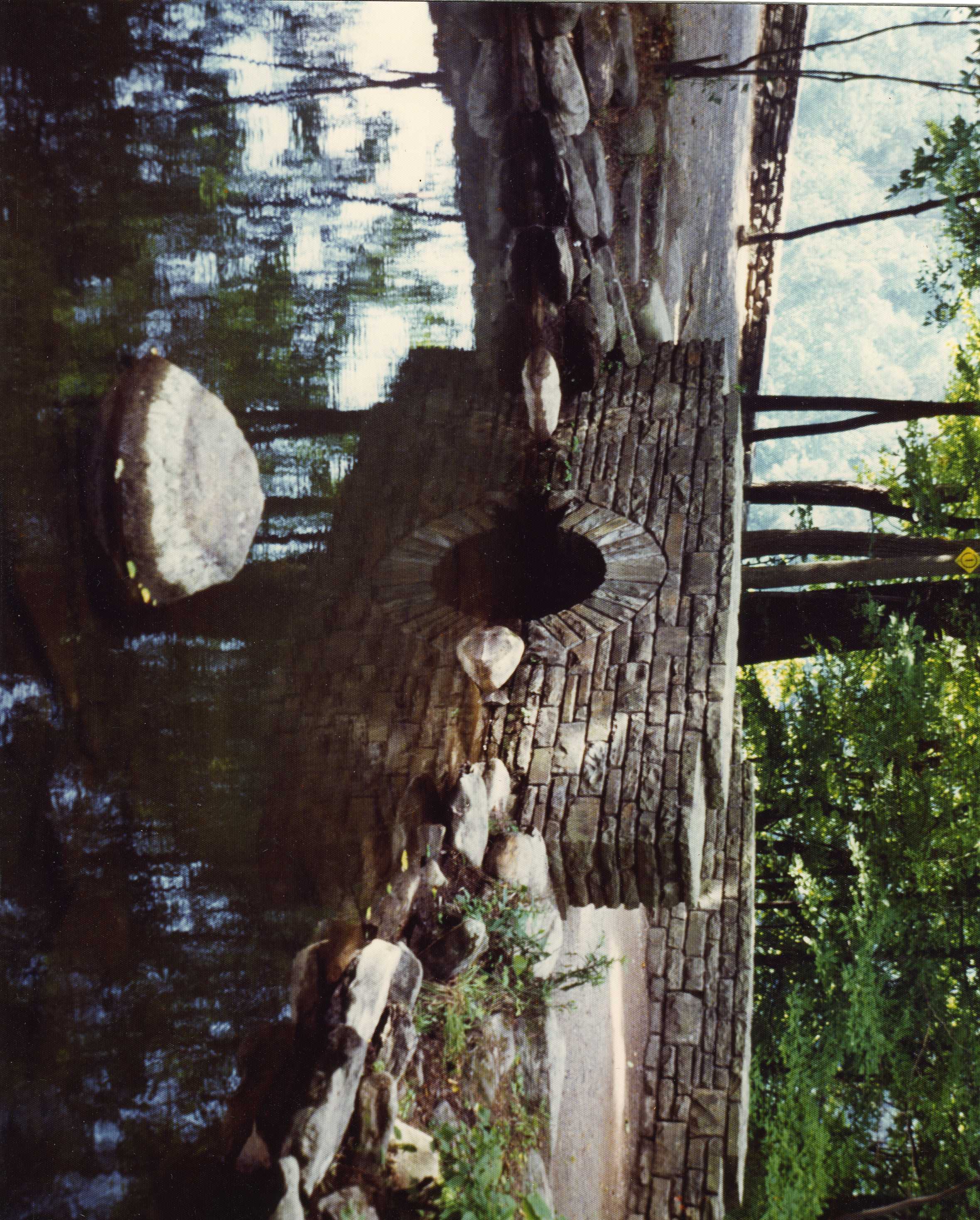

Do not use a cine film. You will have a contrast mismatch.
See the reference above for my method.
Here is an example made on Portra from an Ektachrome slide.
PE

Motion picture negative films are low contrast, and consumer / professional negative films are high contrast. Therefore, motion picture print films are high contrast to give the right contrast to the image. Color paper is lower contrast to give the same contrast range to the image.
Mixing the two systems will give a "contrast mismatch" with contrast generally being too low, and images appearing muddy.
A preflash is not needed. See my attached photo above (Ektachrome > Portra 160, pulled process then scanned). I have a scan of the print as well.
Congrats for the nice job. Still, the water looks a little muddy to me. Maybe it really was... :smile:
