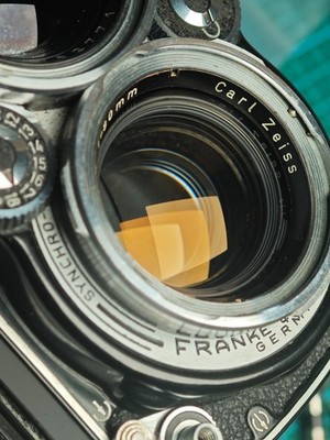

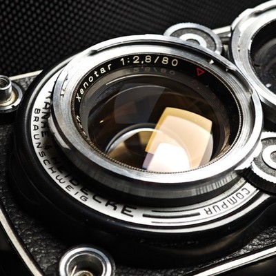

Just saw these on Ebay-
Front lens element for 2.8 Planar and Xenotar. New parts.
Are we entering a period of quick one-off optical element replacements?
(I do know that the front element of the Planar has at least two sizes, having tried to move this piece from one lens to another, so this is one limitation.))

$200 for a single element? Yes, I guess there could be sufficient market incentive to manufacture that.
blee1996
Jul 25, 2008
1,464
SF Bay Area, California
Considering the price difference between a Rolleiflex 2.8C/D/E with good front element and with a scratched front element, there seems to be enough incentive to reproduce the front element. There used to be services to polish and re-coat the front element.

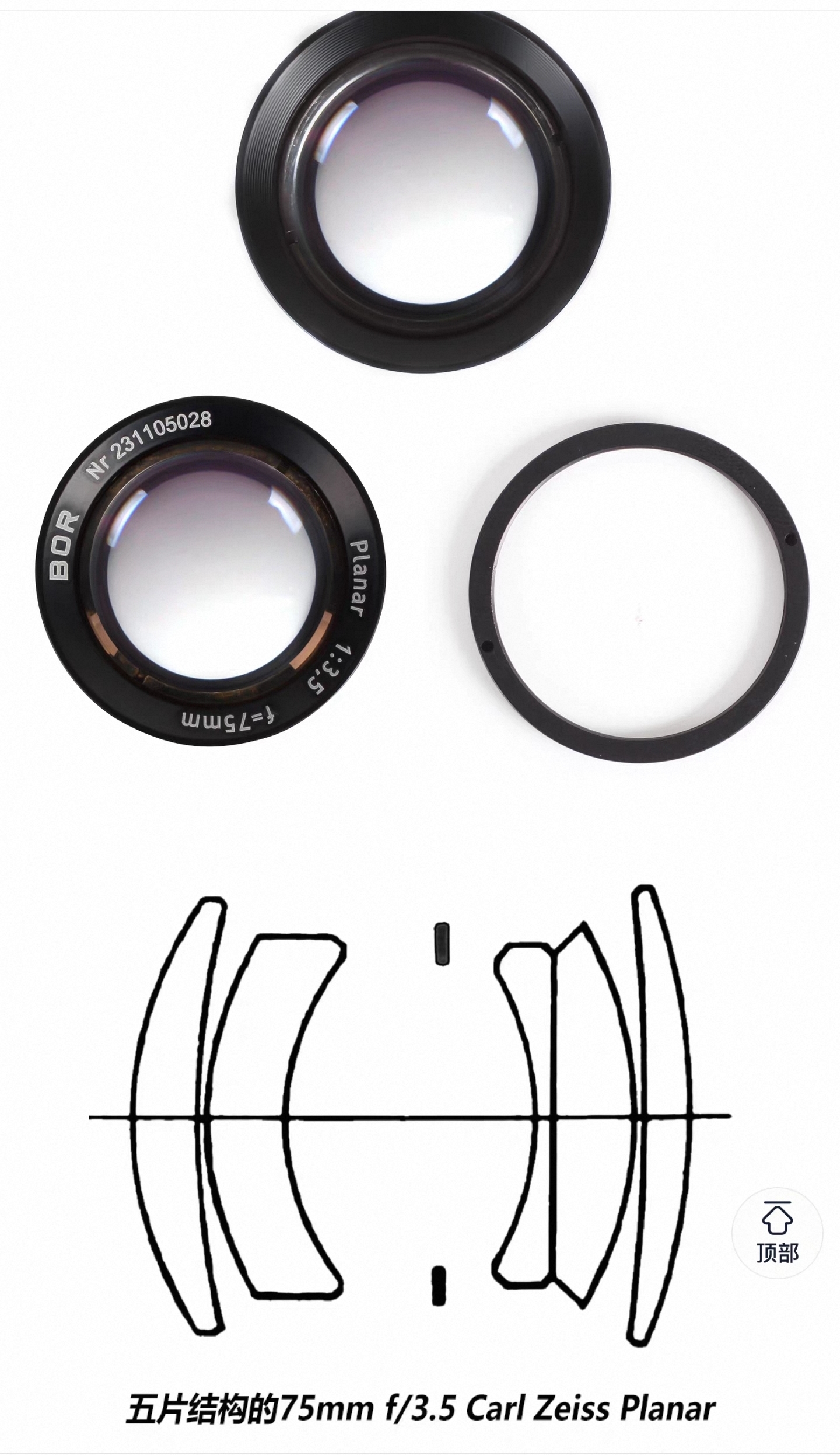

They even made a f/3.5 Planar lens block for Seagull, Mamiya 6, Yashica 124G and other leaf shutter camera🤤
MsLing
Sep 29, 2023
155
Guangzhou China
This thing is what I mentioned. It's about $85.5 in China. Front lens element for Rollei 2.8 is about $83.5. Some shop even manufactured or costumed Hasselblad Zeiss CF80's rear element and Canon Lsm 50/1.8's cemented lens.
