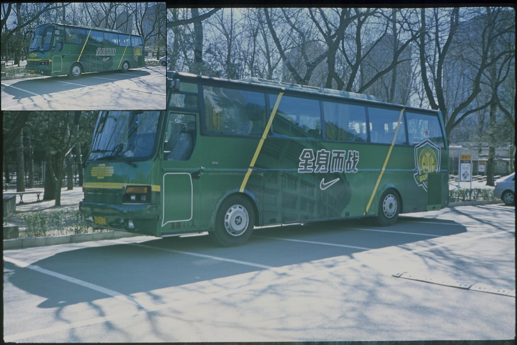

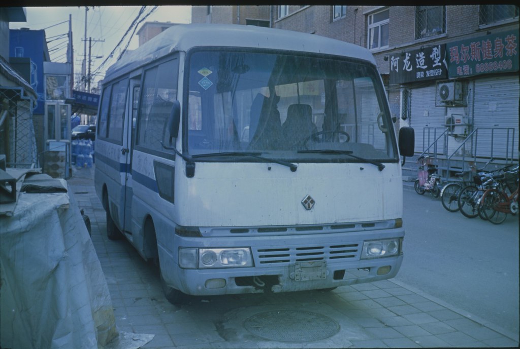

When l processed a E6 slide film by my hand in 2015, the first and second film are normal, but the third got full crazy image. I do not know what is wrong.
I had a similar result about 2 years ago with Ektachrome processed by a "professional" lab which I had not used for some time. After research on the web, the result seemed to point to partly exhausted developer(s). (SFAIK, this particular lab discontinued E6 processing about that time, so maybe they were just not bothered with QC ! Similar films processed by another lab have always been fine.)

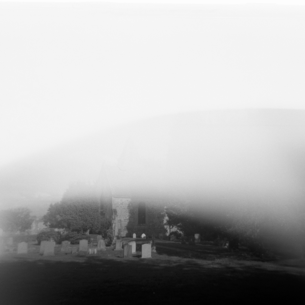

I did just that recently only didn't have your luck and opened the wrong part of the tank quite a bit before I realised. But (luckily?) it was film from a Holga so it added to the 'Lomo' effect... That's my excuse anyway ;-)
I am just about to finish a 366 project, today is my last day. A couple of the 'ruined' shots were the only photo I'd taken on a particular day but I managed to salvage some kind of image, but not something I'll do again deliberately that's for sure!
This was one of my photos of the day. There's just about an image there! You can see how far down the light leak got before I put the lid back on!
