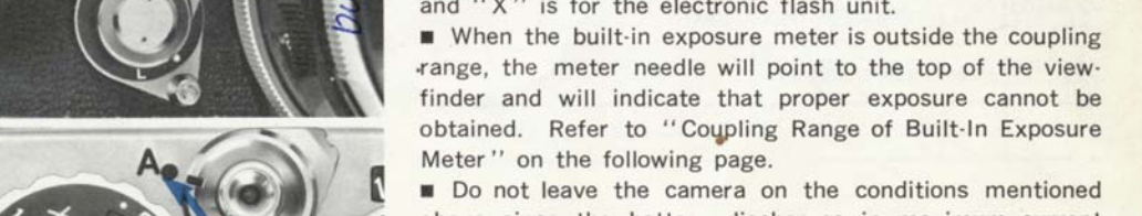

I don't know if this is by design or represents a malfunction, but it's not something I've seen with other vintage cameras I've owned.
I was checking the FT's internal meter against the phone app I have and noticed when I set the shutter speed below a certain value, the meter needle would jump to the top of the viewfinder and no change to the aperture would affect it. For example, if the shutter is set to 1/30 and the needle indicates I need more exposure, moving to 1/15 or slower would cause the needle to do this. But...this was dependent on the ISO setting. At 400, I'd have to drop to 1/8 for this to happen. At 100, it wouldn't happen unless I selected 1/2 or slower. At higher ISOs, the shutter speed that would cause this reaction goes up. At 1600 it was 1/60 or slower that causes the reaction. In all cases the needle would jump without actuating the DOF/Meter lever. Maybe the combination of settings was exceeding the metering range and this was how it warns the user?
The meter is accurate otherwise and at the film speeds I use (100 and 400) the slowest meter-able speeds are at or below the speeds I use, so it's not a problem per se, just unusual.
That said, I also noticed my meter was pretty close to spot on even with a fresh 1.5v battery. Where my phone indicated 1/50 shutter speed, my camera showed 1/60, so slightly underexposed (not enough to notice with B&W print film).

The Canon FT sensitivity range is spec'd at ISO 100 to work down to f/1.4 at 1/4 (using a f/1.4 lens) That appears to be consistent with your described exposuree. Below that, the optional booster is needed. So that might be simply Canon's way to indicate 'use the booster'. (It is not explicitly stated, though.)
An independent review (published by Rockwell) gives a hint about the meter operation:
"While most match-needle meters attempt to show the entire meter range along their scales, the FTb meter scale only covers the range of apertures of the mounted lens. The meter needle's position auto-ranges as the shutter speed and apertures are set."​
BTW, the FT was designed to use the 1.35V constant voltage mercury oxide battery. Many meters do not work always accurately when 1.5V alkaline is substitute, as during its lifetime it declines from 1.5V down to about 1.25V, and the meter is 'accurate' only when it is about 1.35V. An Olympus OM-1 is like that, and in fact the degree of error is also variable depending upon the brightness of the light being measured! I did that test myself when I still had a mercury oxide battery to compared against alkaline. Cameras which use a Wheatstone Bridge circult can use different voltage without affecting meter accuracy...no idea if FT has this type of circuit design. And unfortunately I cannot find anyone stating the result of testing for accuracy of alkaline in lieu of mercury cell in the FT. Most info on the web about the FT simply says to use the MR9 voltage adapting converter with silver oxide cell, or use the Wein air cell.
Be aware there are so-called 'MR9" offered on eBay today that do not voltage convert but which force you to use the shorter life hearing aid air cells...do not buy one if you can see an air hole in the photo of the adapter!

First off: You have the wrong battery, the meter is designed for the 1.35 volt mercury battery which is no longer made in the USA. While the 1.5 volt battery will make the needle move the reading will be off by a few stops. You can use a hearing aid battery.
Second: Yes, it is designed that way. The metering settings are controlled by mechanical linkages. There are limits, this should be explained in the owners manual.
My experience with cameras of the vintage of the FT are that the metering cells have lost some of their responsiveness and will be very sluggish.

I'll be damned. It's right there on page 20 of the manual. I didn't recognize the implication when I read that page though. That said, I don't recall the TL (stripped-down version of FT) doing this, but that was nearly 30 years ago.
Yes, this is indicated on page 19 of the user manual.

It does not. It uses a system similar to the one in the F-1 (galvanometer physically turns when the speed dial turns), but with more provisions for adjustment.
Yeah, I completely missed this detail when I initially scanned the manual. I don't know how I managed to not run into this with my TL (similar, but simpler camera), but I never did while using it in college.
