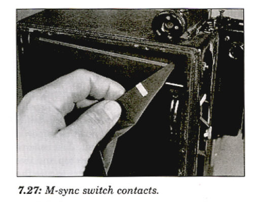

This is the flash sync bit for the curtain on a Pacemaker Speed Graphic, the metal strip is part of the curtain, the two contacts are set into the body.

John, for electronic flash sync it's much the same but the positioning of the metal part on the shutter curtain has to be placed so the flash fires when the largest of the shutter cloth's slits is just fully open. So it would be on the edge of the open slit rather than before it opens which is what's shown shown in the diagram.
