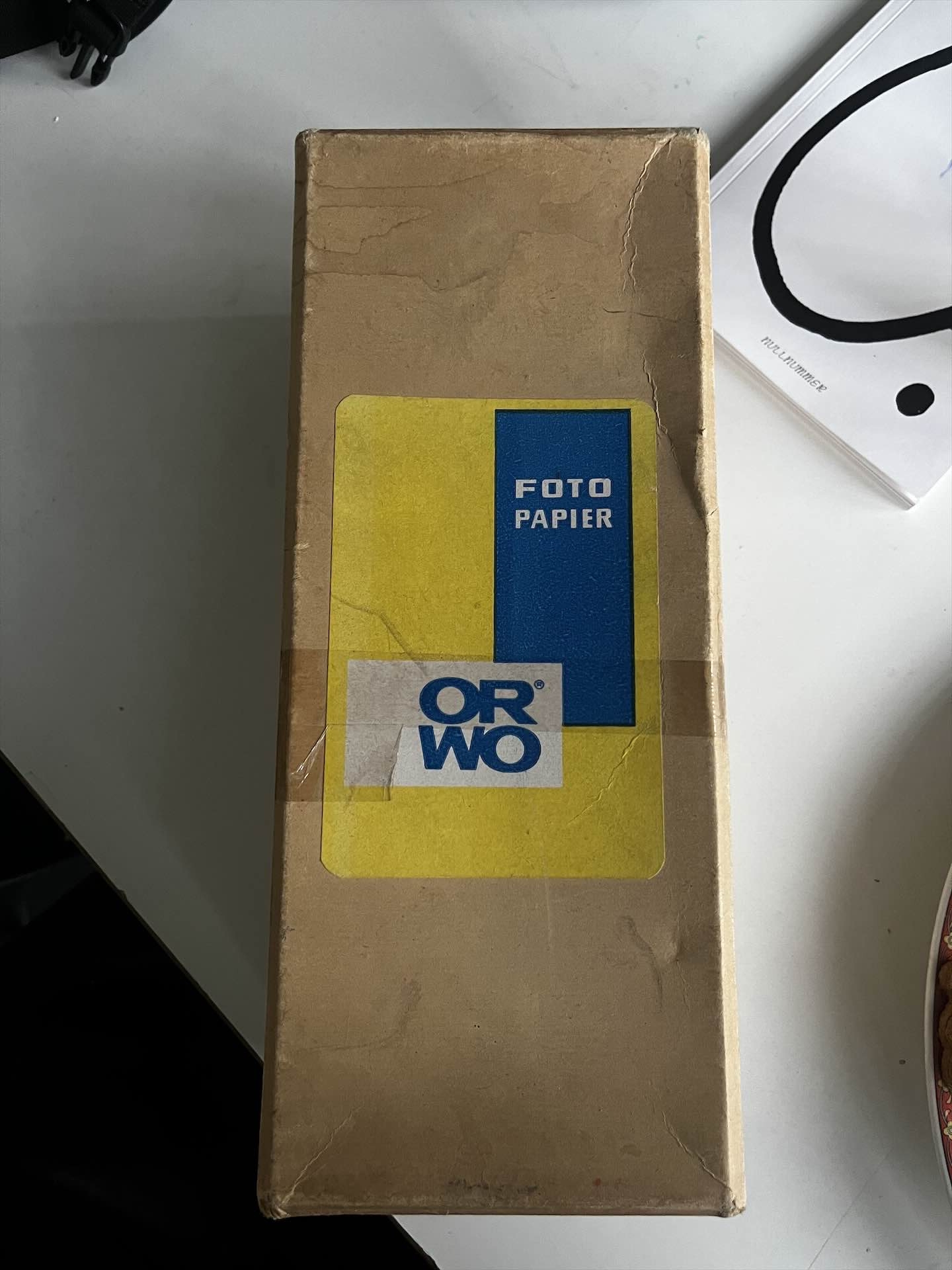

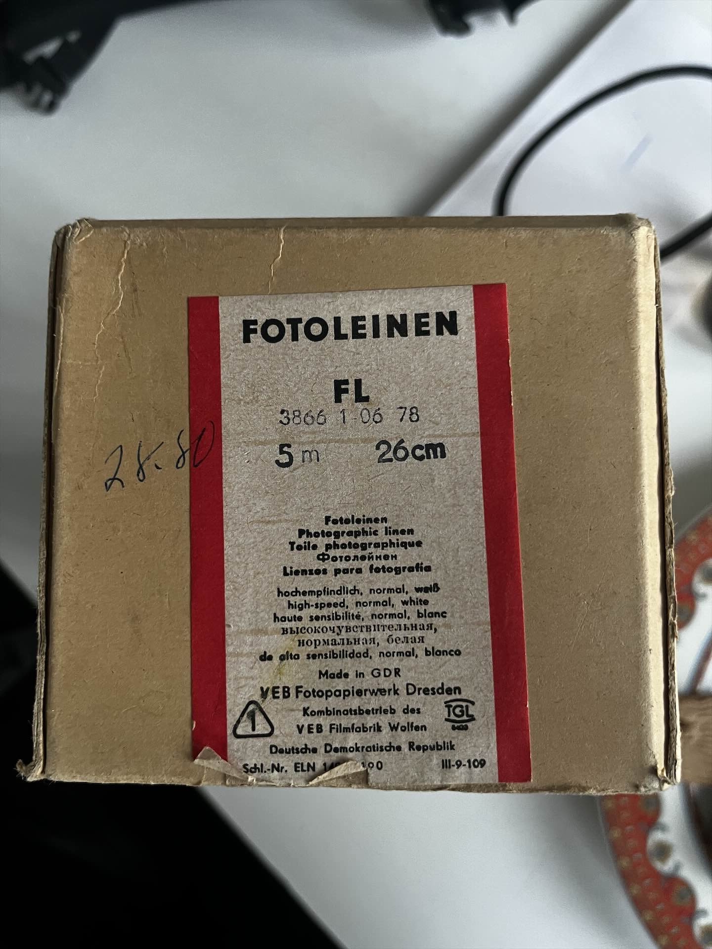

Hi, I recently acquired a box of ORWO Fotoleinen FL (5m x 26cm) photographic paper, and I am looking for detailed information regarding its development and processing.
Specifically, I would like to know the recommended:
1. Developer type and time
2. Stop bath time and dilution
3. Fixer type and time
4. Contrast characteristics and adjustments
As this product appears to be vintage, I understand it might require specific handling or chemicals to achieve optimal results. If you have a data sheet or any relevant documentation, I would greatly appreciate it if you could share it with me.

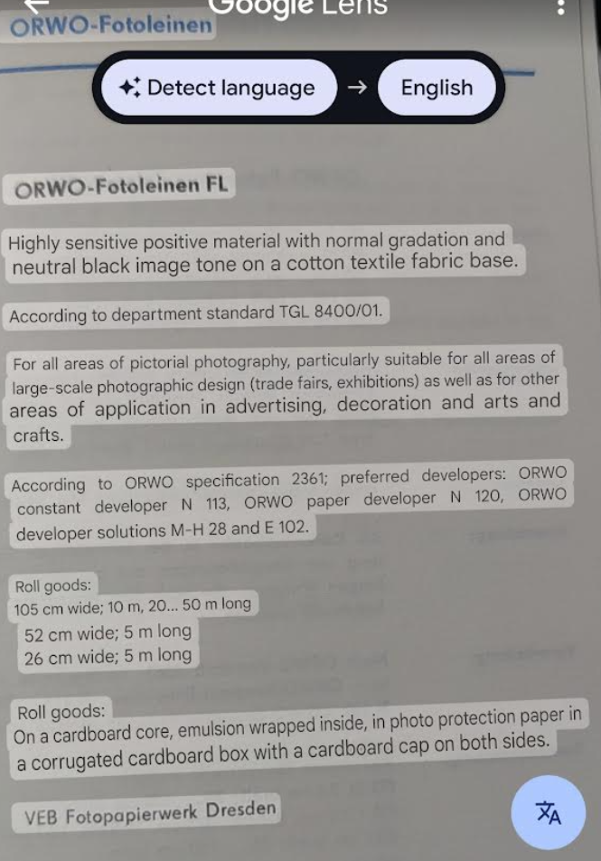

From the ORWO catalog. In the recipe book in instruction 2361 only commercial packaging is listed.
I have official ORWO recipes for paper, but they are not listed in this instruction...

As I understand, Orwo N 113 should be Calbe N113 which should be the same as ADOX Konstant (see here), and ADOX still sells an Adotol Konstant II product. https://www.fotoimpex.com/chemistry...-capacity-paper-developer-to-mix-1000-ml.html Its MSDS lists hydroquinone and I assume phenidone is also present.
IDK about Orwo N 120.
Orwo M-H-28 / Calbe MH28 is apparently a metol-hydroquinone developer (https://www.photo.net/forums/topic/42944-website-from-calbe-fotochemie-online/)
IDK about Orwo E-102 a.k.a. Calbe Uniprint, but it seems yet another general purpose developer used for film or paper.
I interpret this as "use whatever reasonably vigorous developer you happen to have".
