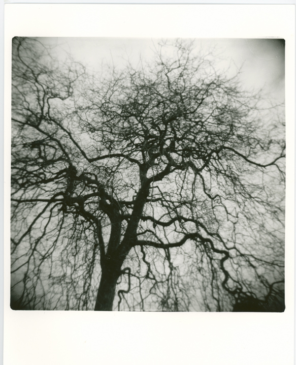

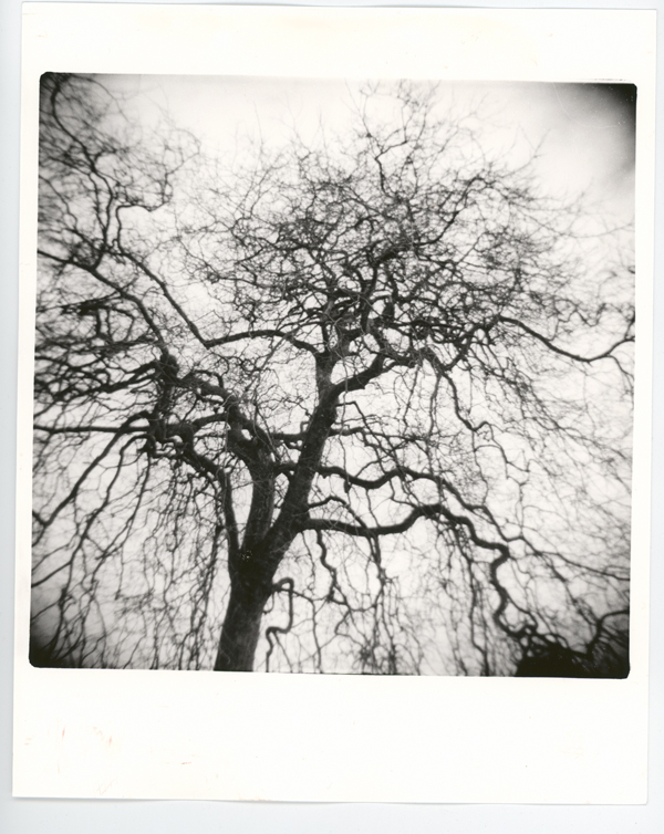

Indeed the strongest shift occurred within the first 5 minutes, using RC. I noted changes at 15, 20 and 30 mins, all of which after the 5 minute mark were really quite subtle. No significant loss of dmax that I can see using Ilford selenium after an hour, at least compared to an untoned print, which would have lighter maximum black in any case. So I wouldn't be surprised at slight reversal in d-max at some point in the toning process. I've really been wanting to get a hold of that Rudman book... I know its been reprinted in the UK, but even then still quite pricey. Here is an untoned and toned sample of the print in question: Work Print_a.jpg Work Print_b.jpg

I think some of your problem may be that your image is a high key image for the most part. Not a whole lot of silver is your image besides the tree itself. I have notice that with a high key image the reddish purples don't seem as strong because the intensity of color in the highlights is just not as strong. Try a print with more midtones and shadows and you will see what I mean. If you're looking for a reddish tone with this type of image I would recommend fully sepia toning with a middle range of accelerator and then gold toning until you get the tone you desire. This will get you the red tones you're looking for, but gold toner is rather expensive but does last a long time. Or you could try copper toning, which is not archival. I've never used copper toner. You really need to get The Toning Book by Tim Rudman. Great book.
