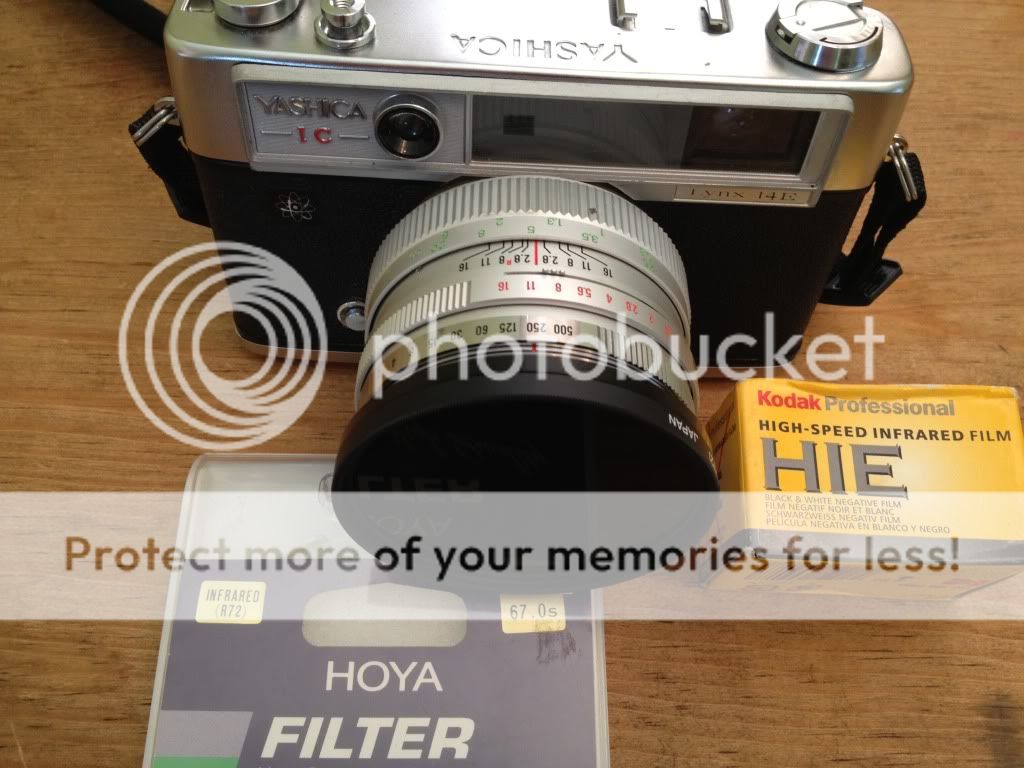

Instead of starting a new HIE thread, I am continuing an old one.
So I've the below: 35mm RF (Yashica Lynx 14E), cold stored exp 2008 HIE, R72 Hoya 67mm thread, step up ring 58mm to 67mm (this is bc the Yashica is a 58mm and the 67mm can also go on my MF camera - two birds one stone....).
I am going to use what Mick says above.

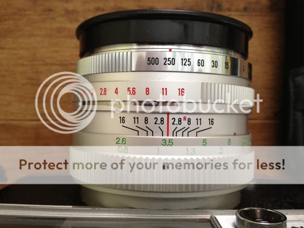

Question, so if my object was 3.5 feet away, would I just focus normal with the RF:
Then turn it so the 3.5 foot mark is in the mark with the 'R'??? See below:
