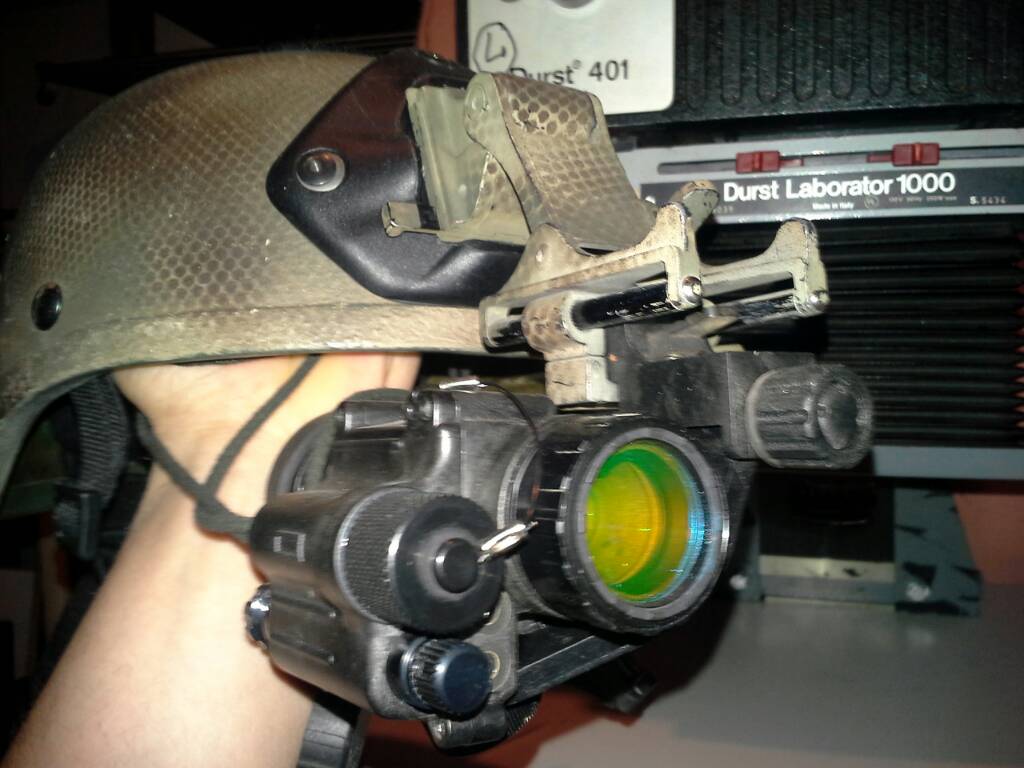

I use a PVS-14 moncoular I bought while doing some contracting work overseas. It's really overkill for the darkroom, I had a new tube installed last year since the original one had some burn in from being mounted behind a illuminated rifle scope. It's a gen-3 tube and is crystal clear when I use the IR illuminator. I've been using this combo for 2 years now and it works great. I lost the head mount that came with the unit so I have it attached to a helmet which causes some neck pain when looking down into trays during a session.
I'll post some pics when I get home.
