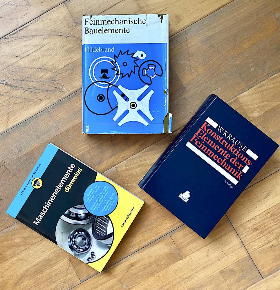

I'd think German would be the ideal language for learning about feinmechanik!
German-language books from my collection.
The insidious circlip even made it onto the cover of the book in the middle! 😝
I asked this question here a while ago, but couldn't find anything else on the topic.

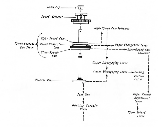

Andreas, if you want to learn what every lever and spring in a 35mm SLR does, the answer is hidden in the NatCam manual "THE SINGLE-LENS REFLEX."
Kind of hidden in that book every aspect of the Nikon F is deatailed. From disassembly, to function of every part in health and disease, and re-assembly. I have never encountered anything so thourogh for any other SLR. Not even Nikon F2.
Now you know why I got a Nikon F.
Also, that book details the Pentax Hv3 in a similar manner. The Rollei SL35 is somewhat a copy of the Hv3; now you know why I started working on Rollei SL35.
Thank you!
