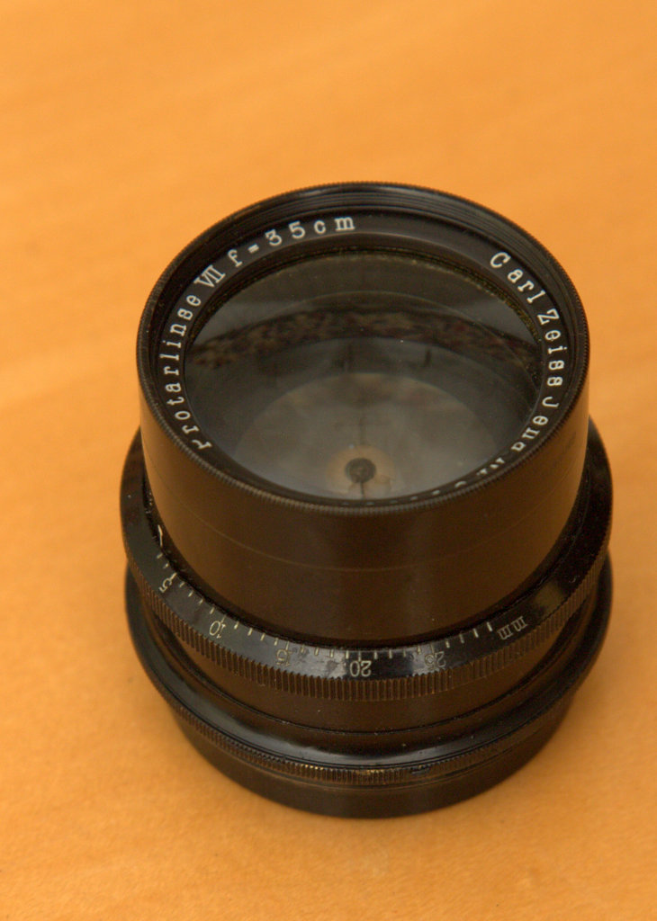

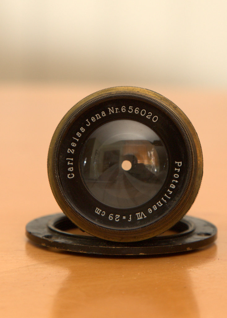

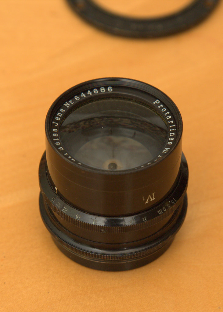

This is another lens from friends grandfather. I can't seem to find a lot of information or a value so any info I could get will be appreciated.

There are two different lenses in your photos.
shutterfinger
Feb 25, 2013
5,018
San Jose, Ca.
The 35 cm serial number is mid range of the numbers listed for 1925; the serial number for the 29cm is between the end number listed for 1925 and the beginning number listed for 1926. There is a 18,000 gap in the 1925 to 1926 numbers. (from A lens Collectors Vade Mecium)
http://www.cameraeccentric.com/html/info/zeiss_1.html shows it as a Selected Convertible Set for 7 1/2 x 5 plate size.

Some of this may be redundant and repeat some of the useful information also posted over on the large format forum. Anyway: This is a Zeiss Double Protar, the front cell of 35 cm and the back cell of 29 cm focal length combine to make an objective of 18.5 cm focal length, maximum aperture of f/7.2 (Sometimes this is rounded off to f/7). It looks like your aperture ring is graduated in f stops for the combined lens and is engraved with the combined focal length, 18.5 cm. Either cell can be used alone behind the diaphragm. Here the aperture ring's millimeter graduations are used to set the f stop. The maximum aperture of a single cell is f/12.5. See this:
http://www.rontalis.com/tech/protar/index.html
If you scroll down to the bottom of the page there are links to charts giving the millimeter settings for f stops for both the single cells and pairs of cells.
