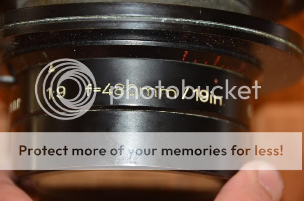

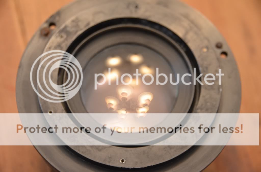

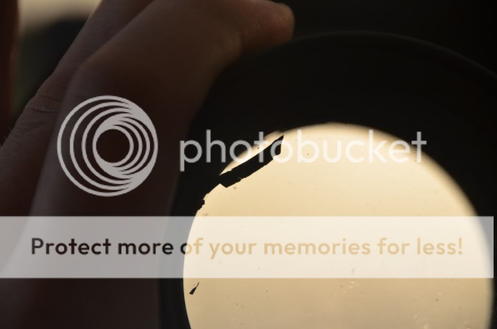

I bought this at an antique/junk shop. Lens is in terrible shape (fungus and haze) plus some of the black paint under the first front element has started to flake off onto the glass. (see image). The iris works like a charm and stops from f9 to f260.
Is this lens pretty much useless or is this a good find? Paid very little for it so I figured I would “rescue it”. It was in a junk shop that had no heat/ac and has probably sat like that for years in the humid and frigid Midwest seasons.

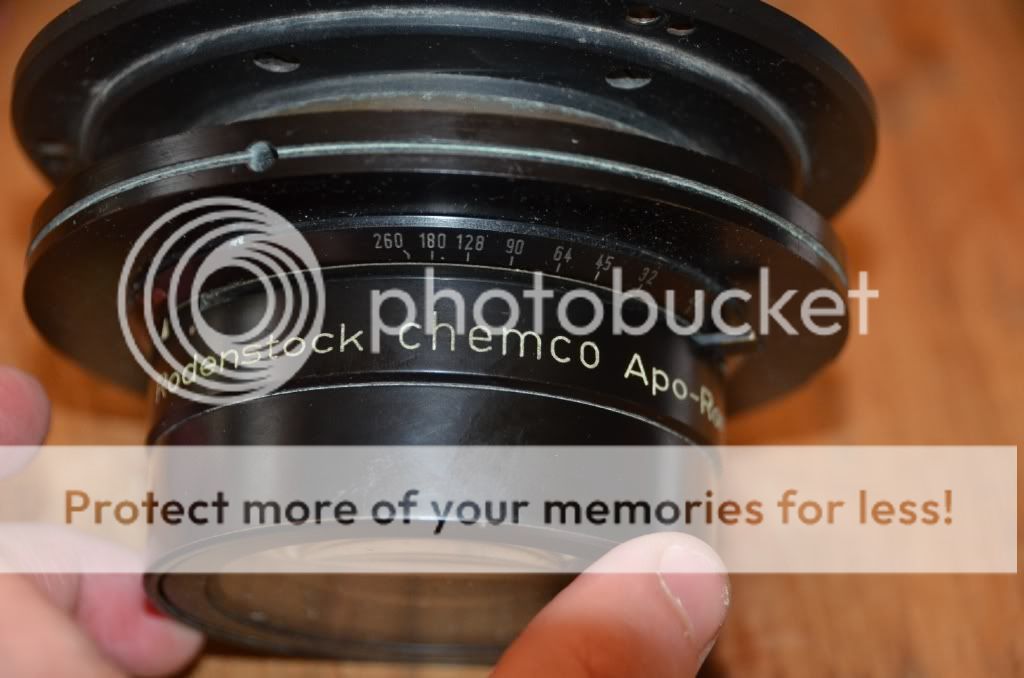

I am not able to find much info re this Rodenstock chemco Apo-Ronar lens anywhere. Is this some sort of copy production lens? What is Chemco? I believe the focal length (480mm), allows for 1:1 reproductions from what little I could find re this?
Feel free to enlighten me what I have. I am really a 35mm/MF kind’a photog, but I always tell friends who ‘junk’ if something has lots of glass, is heavy, made in Germany and cheep get it and figure out later if it was a good buy later so I had to pick this up instead of let her sit through more painful days with no love.

rodenstock was the manufacturer
it was probably used for the graphic arts/reproduction(flat work primarily) industry. AKA "plate" making before digital platesetters
it'll work as a taking lens, and will cover 8x10 wide open, possibly larger when stopped down enough. Its "sweet" spot from what I've read is around F/16-22
it's multicoated, (see the multiple reflections in your 4th picture)

I've never seen one with "chemco" on it. No idea what that means- the font looks a little different as well, perhaps a company had it engraved? Get out some lens cleaning solution and a microfiber cloth and see how clean you can get it.

This might shed some light on the “chemco” name appended to the Rodenstock process lens. This would have been a customer request that the process lenses used on chemco products also bear the “chemco” brand.
Similarly, we sometimes see Schneider lenses with the additional “Durst” name added to the barrel.
http://www.trademarkia.com/free-trademark-search/photomechanical
