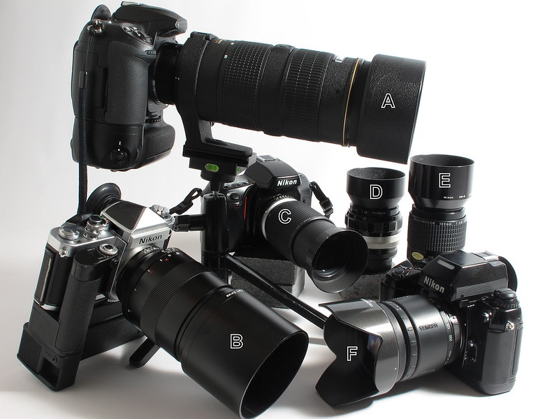

I have tried a number of portrait lenses on my Nikon SLR. Some expensive and some inexpensive. Here is my recommendation for some of the inexpensive ones I use:
Tamron 28-200mm f/3.8-f/5.6 auto focus (72mm filter)
Nikon 75-150mm f/3.5 (52mm filter)
Nikon 135mm f/3.5 (52mm filter)
Nikon 105mm f/2.5 (52mm filter)
Nikon 105mm f/2.8 macro (52mm filter)
Nikon 85mm f/1.8 (52mm filter)
Portrait Lenses by Narsuitus, on Flickr
