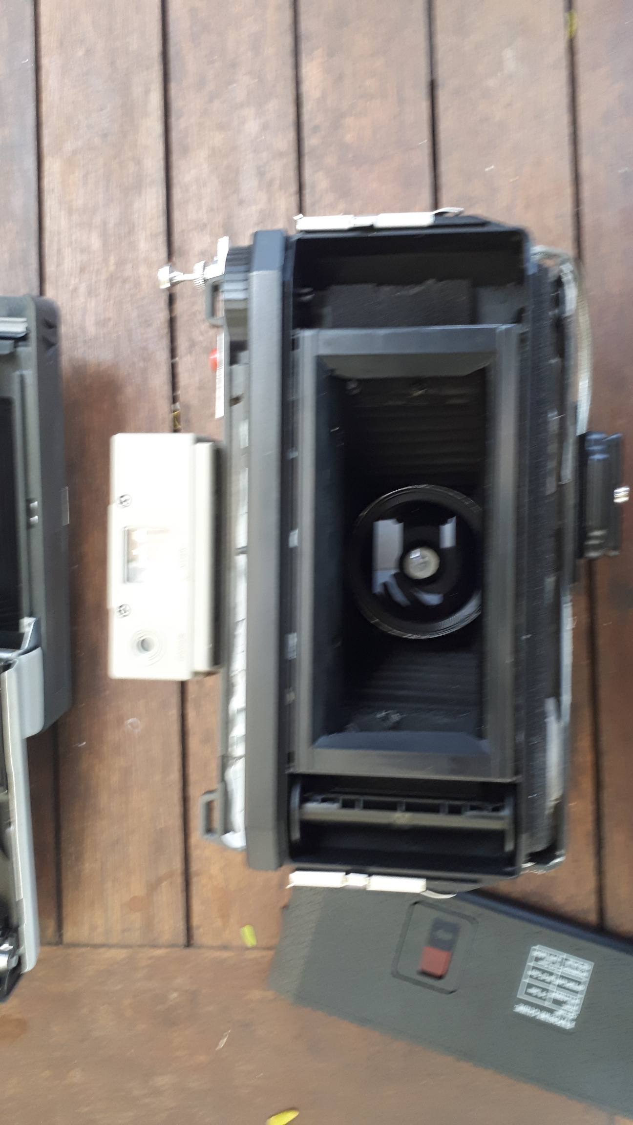

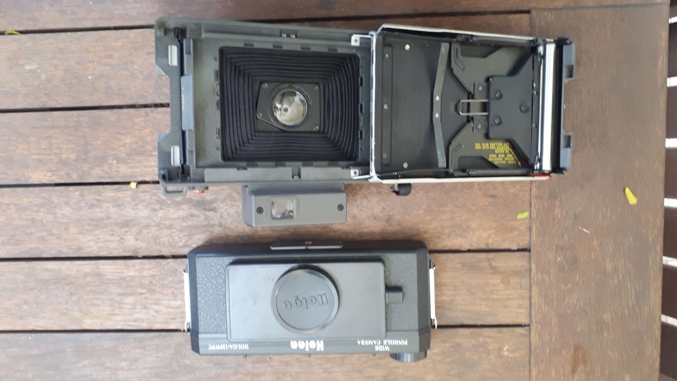

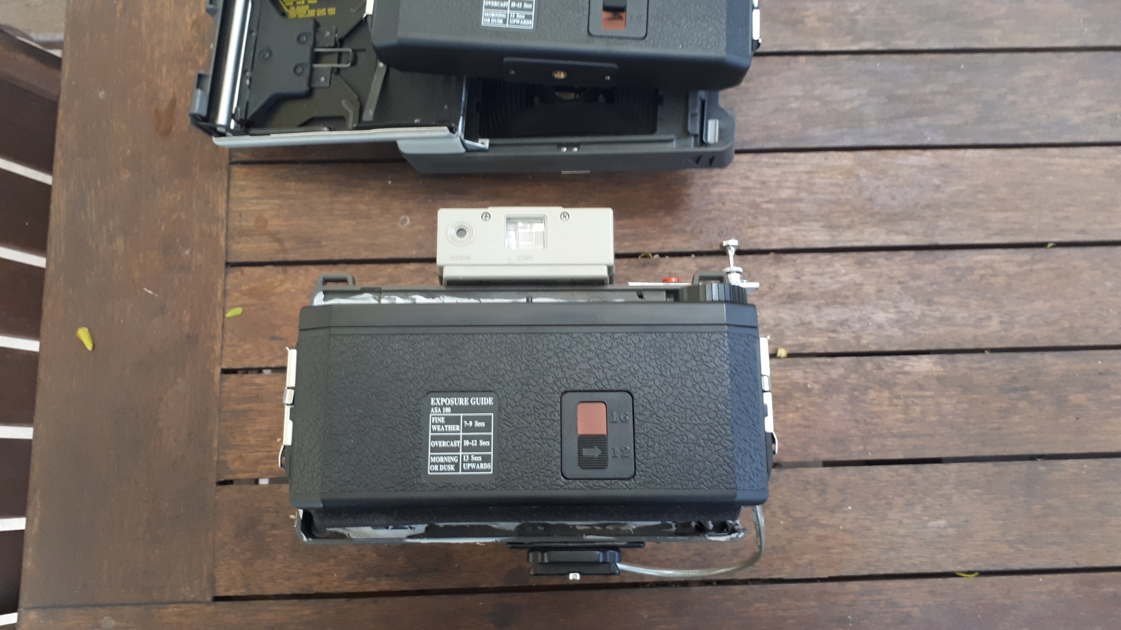

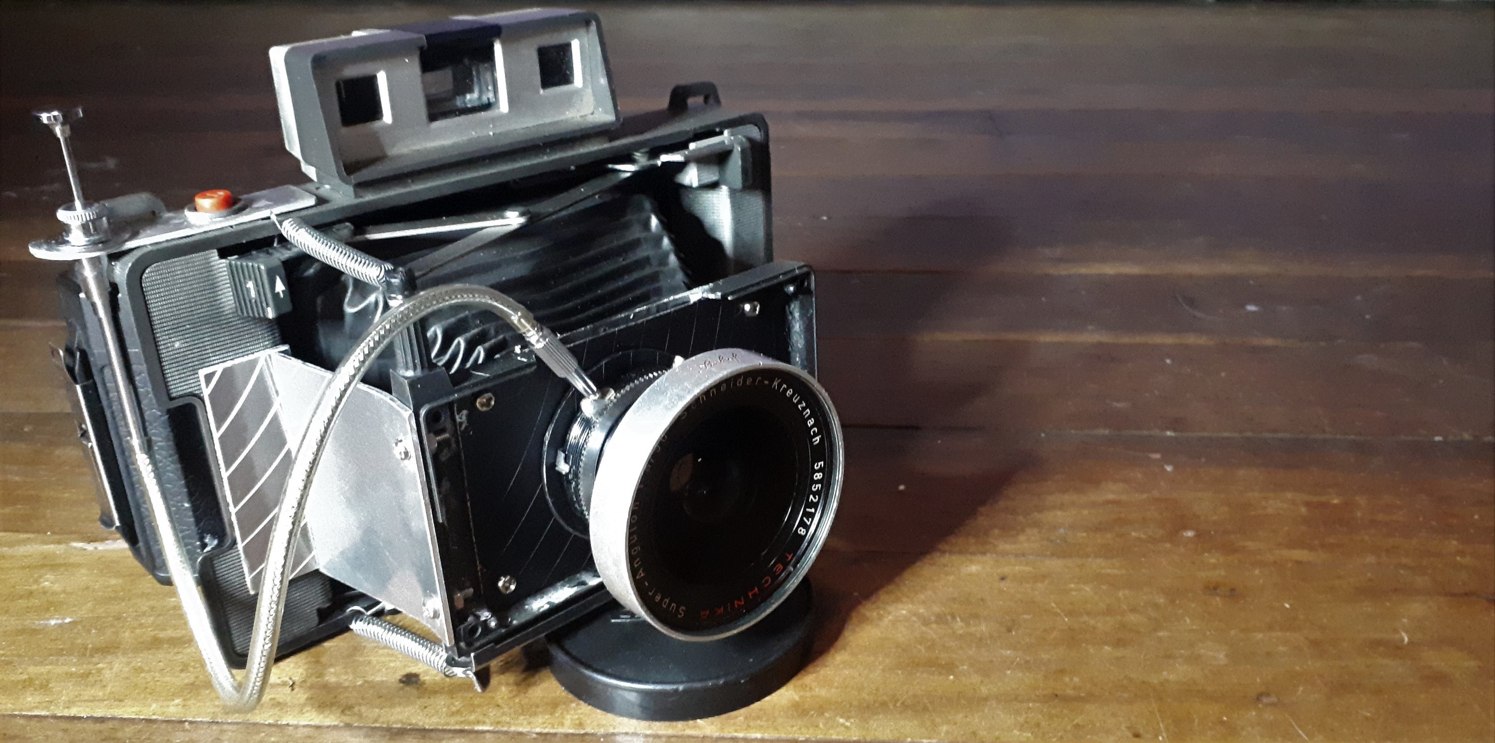

I made my own using the back of a holga 6x12 pinhole camera, attached to a Landy, with a 90mm super angulan,, super light and I can extend the bellows for close ups...Cheap and easy, just like me
Dont see why you couldnt attach a film back.
View attachment 246570 View attachment 246572 View attachment 246573 View attachment 246574
Wow, that is awesome. Any chance you have something written up on how to do that conversion? And how do you focus, rangefinder or ground glass?

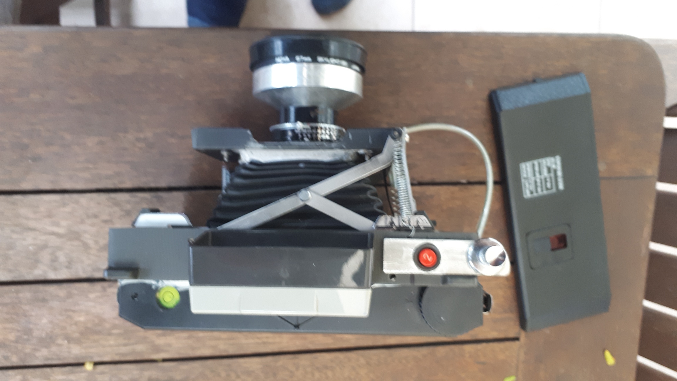

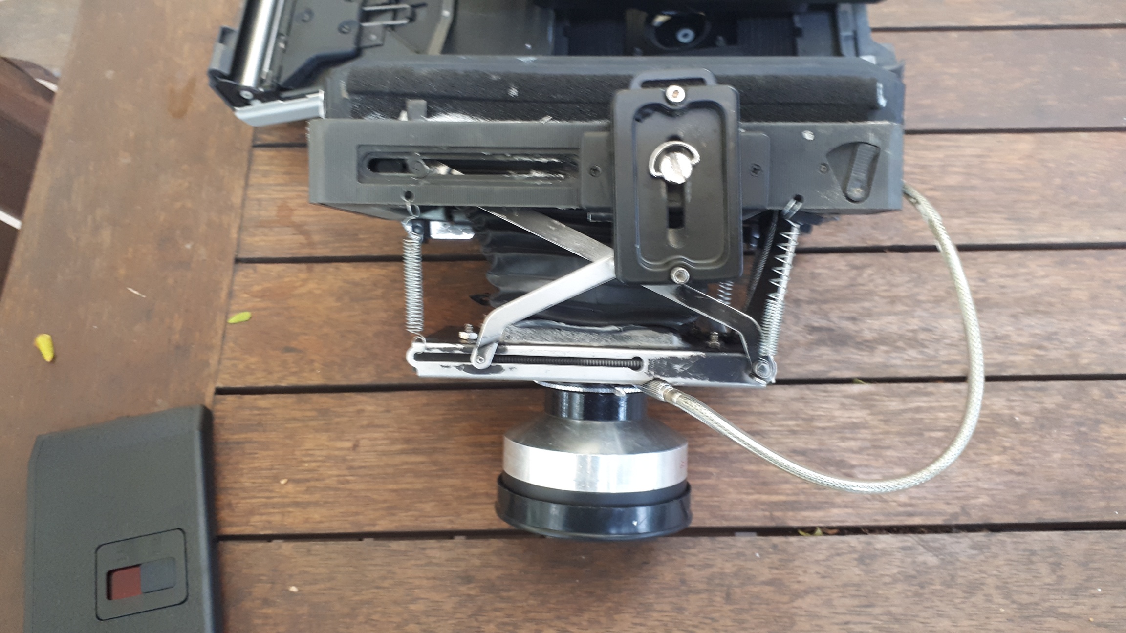

No, but I took some after pictures, its pretty straightforward, just a bit of dremeling and sealing up the light leaks. The film holder is permanently attached, so I zone focus ( guess) and f22 fixes any inaccuracies. Use a home made ground glass to set infinity and can use the slider to push the bellows forwards for close ups. It wouldnt be hard to do a better job and use a removable back, but they cost so much. I paid $200 for the lens, $100 for the holga and land cameras can be bought for lose change.
If you aren't sure of something, ask.
I plan on making another with another focal length lens.
