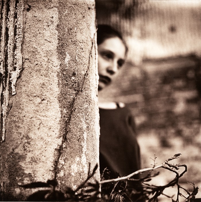

In such a situations I usually make the print on the dark side in order to get good blacks, then I immerse the whole print in diluted Farmer's Reduces in order to clear the whites. With such a procedure you gain also a spectacular highlights separation, sometimes I do it only for this.
