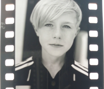

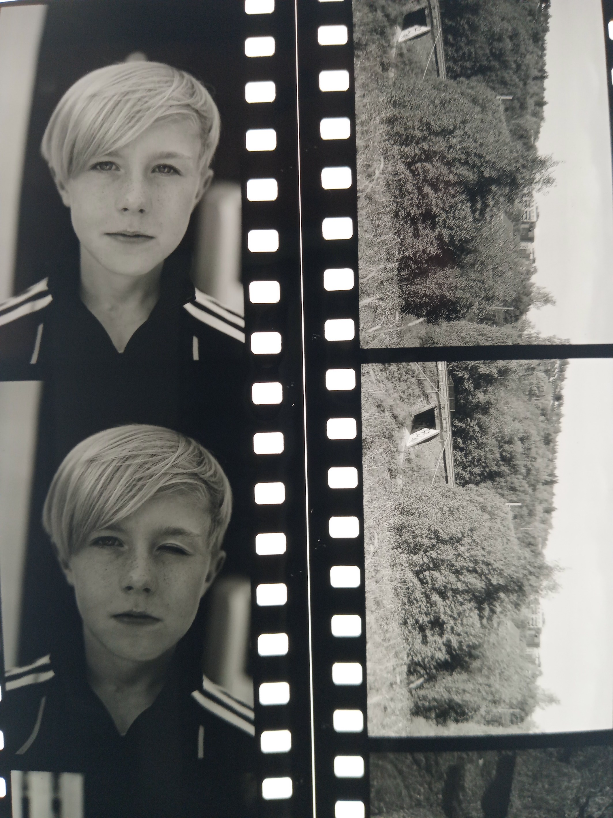

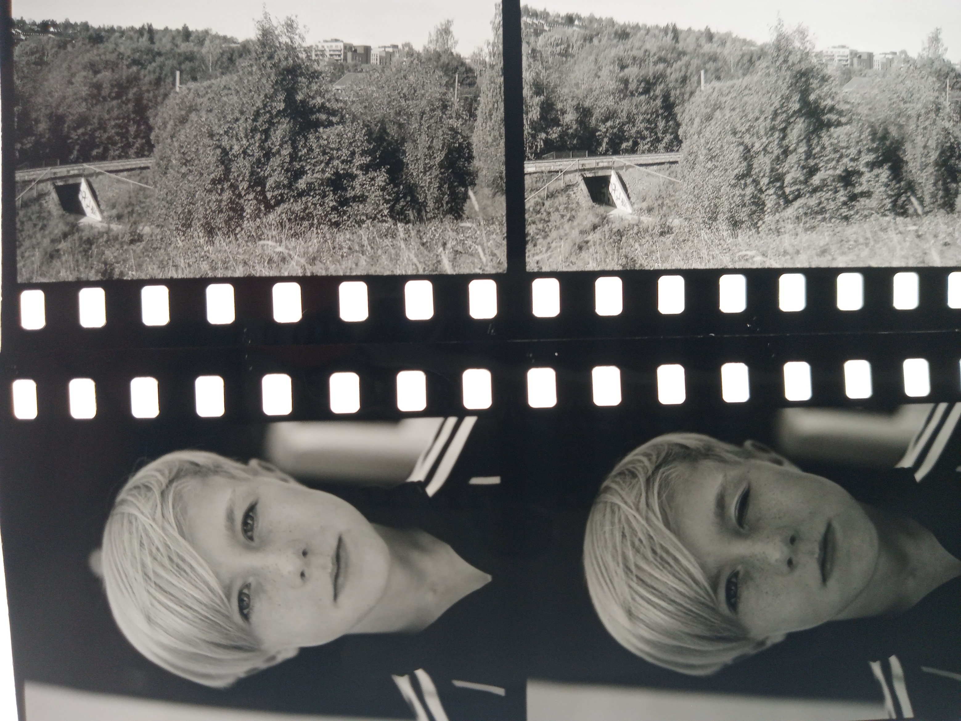

I just developed Ferrania Orto at 50 (box speed) and 25 ISO (with 2g thiocyanate/L). Looking over the photos I'd say my son's face looks good at 50 while his hair (blond) looks more correct at 25. Other shots does lack shadow detail - but this is also the case for this film if developed as a negative and compared to a film like Ilford Ortho Plus. Anyway, I'm not sure how to determine if I should increase the amount of hypo (I've just started using thiocyanate) or first developer time? I guess I'm assuming if I increase hypo levels and expose at 50 I'll get the same skin tones while getting a brighter more realistic hair tone?

Mobile scans:

Have you used ortho film before? if not, skin tones might not look the way you expect.
Also, just looking at those scans, 50 ISO looks underexposed, and 25 looks about right. Processing won't change that situation significantly.

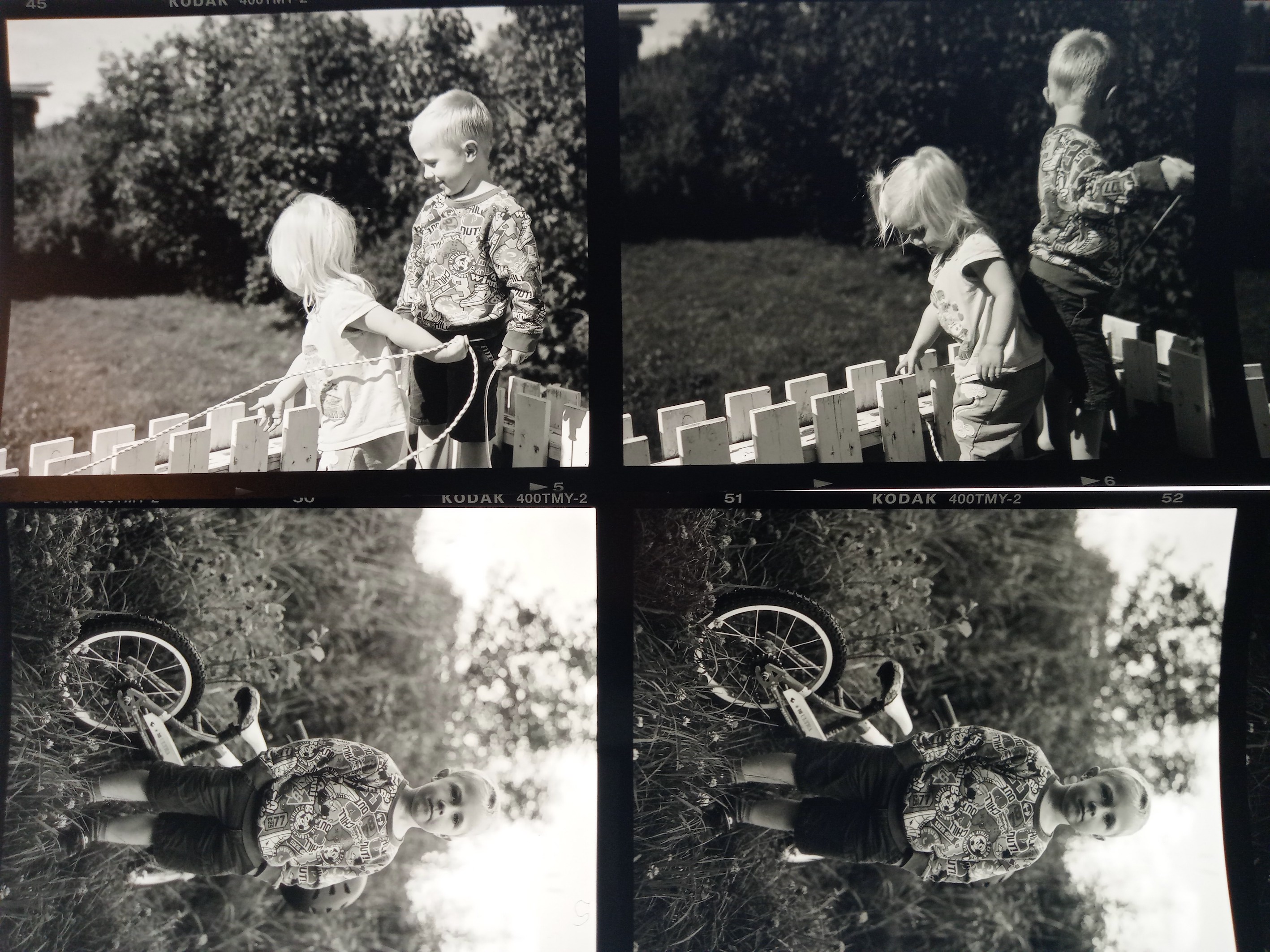

Thanks guys. Ive used quite a bit of Ortho-film - in many cases I prefer it. The ones exposed at 25 are slightly flatter and I have to admit it annoys me a little bit. I hade these results with Tmax 400 a few years back (also PQ, no hypo, and permanganate instead of dichromate):
These are exposed at 100 and 200. The one with the bike can also be seen here: https://peterrisholm.com/#jp-carousel-1312
I also like these, but the Orto ones are a lot less grainy and holds more detail (so better suited for 135 especially). I do like the warmth and glow of these though. When I tried reproduce these results it failed. So i either I messed up when I reproduced them or I made an error when I made them the first time and dont know what it is.

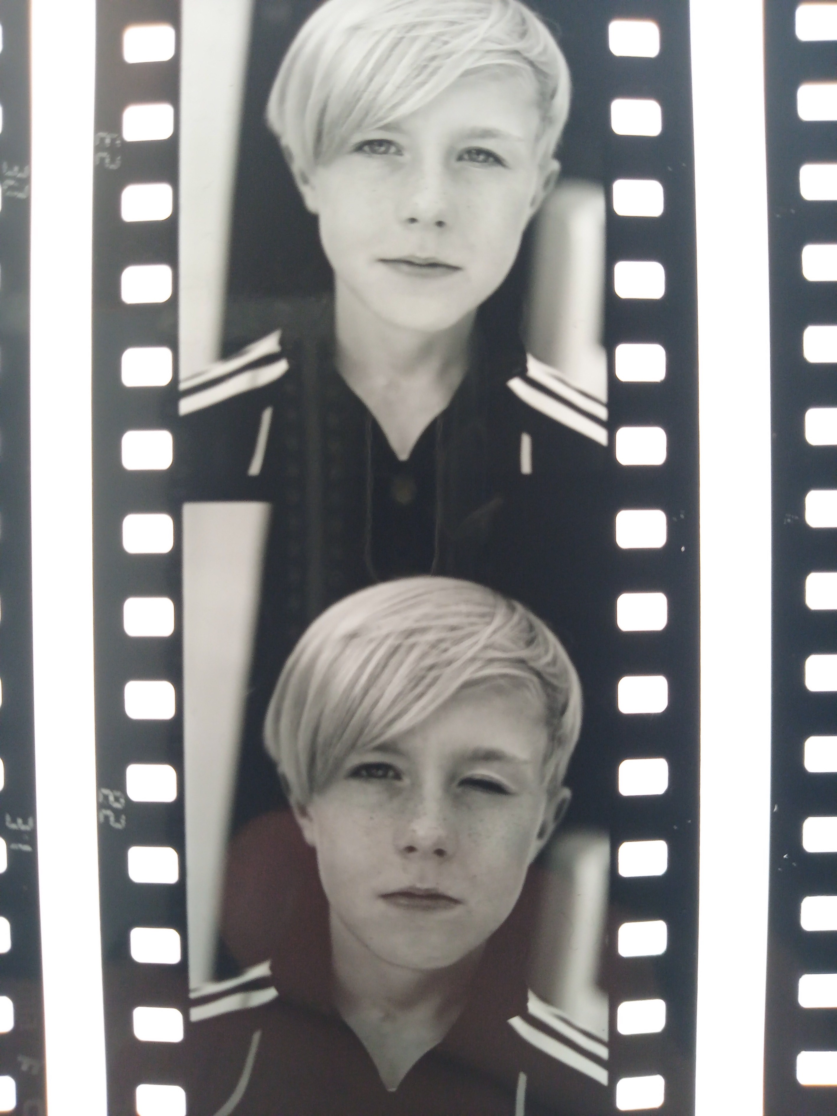

Yeah, definitely. It's always a little challenging to judge transparencies this way, I find, because the intensity of the backlight does so much, as well as exposure of the digital image that we're looking at. For instance:
I assume these are the exact same frame. The one on the right looks bang-on perfect, very pleasing (and a compelling portrait to boot). The one on the left looks flat and dark, overall.
I also suspect that the one on the left is more representative for how the actual slide looks in real life.
Overall, I'd be inclined to experiment both by increasing exposure (so going down to ISO 12) and adding more solvent to the developer. It would be great to do some snippet tests of various combinations to find the sweet spot. I think in the end you always walk away with the observation that exposure + chemistry are ideally tailored to the contrast range of the actual scene, which of course is a little inconvenient when working with roll film. Testing with some mixed-scene images would be the way to go to settle on a usable compromise.
So in short, I can only say "continue as you've been doing"; you're going places.
