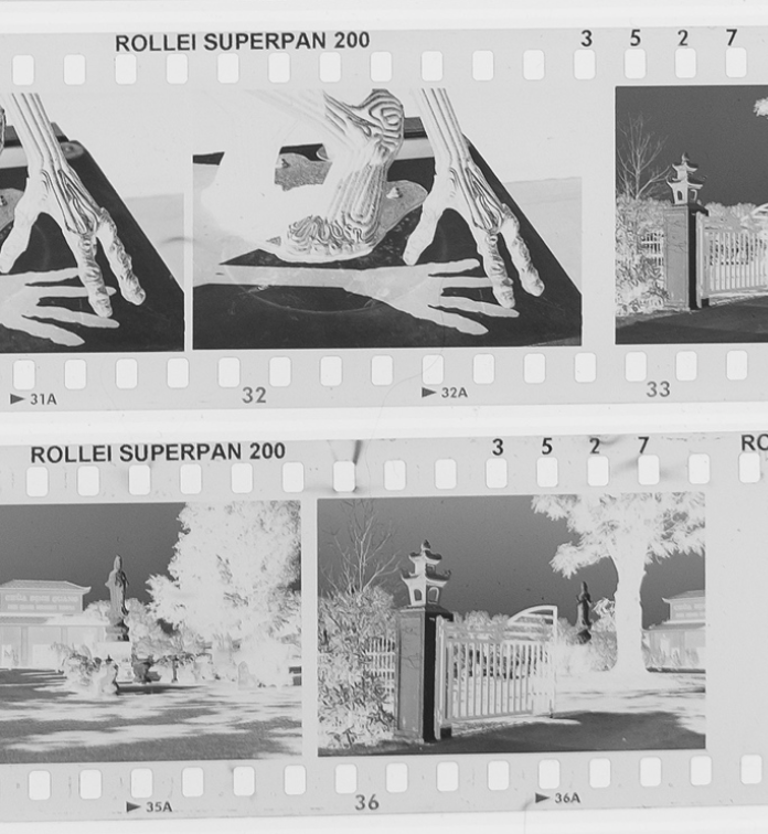

I've shot two rolls of Rollei Superpan, one in 2022 and one in late 2024; both had edge markings. But both of mine were purchased as 135 cartridges in retail boxes.
Yes, see also @Daniel Stuefer 's post above. But is the same true for bulk rolls? I'd expect so given the fact that other Rollei films have these markings also in bulk rolls (at least the RPX400 I shot some years ago did), but IDK for sure it's also the case for this product.
Either way, @Don_ih's suggestion of having a look at the leader is a good one. If it's hand-rolled from bulk, the trailing end may also be exposed and thus should have density. Depends a bit on how you load the film of course.
